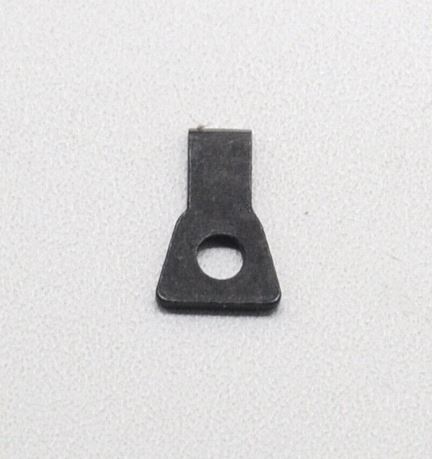

Hi everyone - OK, so I've got the vertical adjustment on my Baikal IZH 46M set as far down as it will go and I'm in the 7/8 ring. I aim 'sub 6' style already, so it's not like I can just aim lower.
Has anyone adjusted the front sight up? Is there a longer blade available (I can't find one on Google, but...). Or can the rear sight be moved down somehow?
Or is it a technique thing? Gotta be said, I'm grouping pretty tight in those 7s and 8s.

You need a taller front sight.
A quick google search got this image for the front sight
It looks like something that you can cut out of back plastic (bottle, packaging, Eley .22lr box, etc.), if you are not able to work with metal.
Drill it first, then cut the shape around the hole. Leave the sight long, and cut it as needed so the rear sight is near the middle of it's adjustment.
I've done countless rear and front sights from all sort of material, from plastic, aluminium, metal. They all work great, and are far easier to make than they look.
Hope this helps

I had dismissed the idea of making one because while I have most of the tools, I don't have a bench and a vice for working with steel.
But I had not thought about plastic or aluminium! I'll have a poke around for something suitable.
Thanks for the inspiration!

I used a bit of plastic that used to be a battery cover for one the kids' old toys. It's about the right thickness and a slightly smaller hole that the metal original allowed the grommet screw to hold it securely. Now the elevation is set in the middle and I'm hitting the middle of the target - success. Thanks again, rmca.
