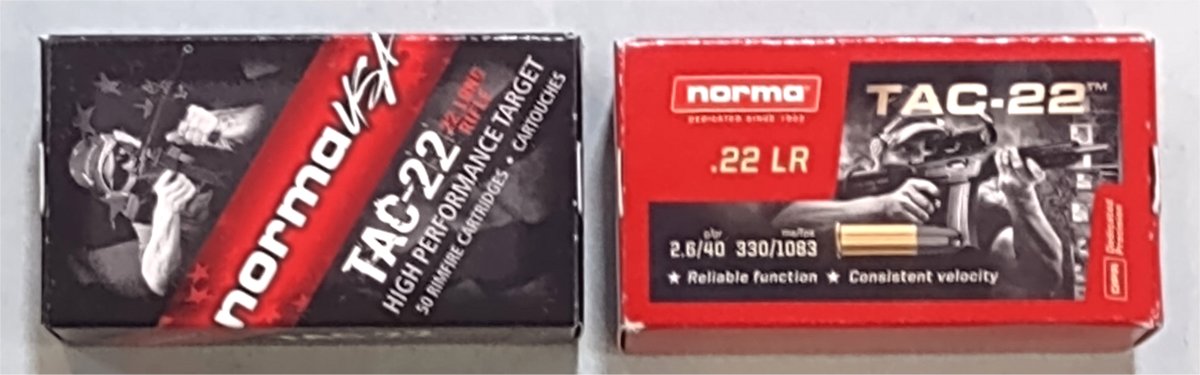

Apparently there are two flavors of Norma Tac-22 around. There is black box & red box:
The black box is older, and VERY greasy. The stuff I tried that worked really well was the red box, which has a much nicer lube. I think it's harder & thinner, so it's not nearly as messy. My guess is that it's the same basic ammo, but they got enough complaints about the lube that they changed that.

Totally agree on the black-box Norma TAC. Drippiest ammo I've ever had the displeasure to shoot.

I just bought some Tac-22 that has a RWS headstamp.

For the last maybe 20 years every sort of Norma 22rf has been manufactured by RWS.
