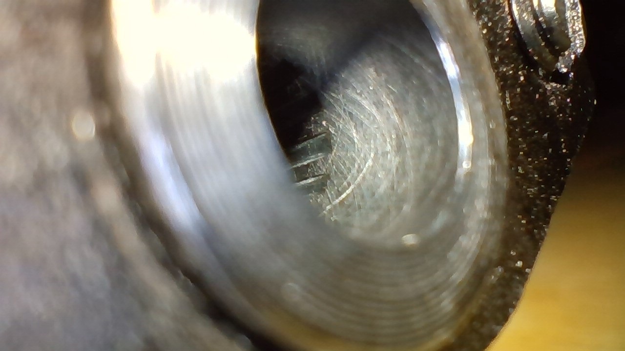

My borescope is 5mm, too large to even get into the crown. But I lined up a little bit outside it for a closeup.
The lighting is poor and the reflections make the crown look rough, it really isn't. But what it does faintly show is that the actual crown angle is not flat, it goes in as a 5.8mm cylinder at first, then seems to take on a ball shape. Interesting.

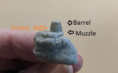

Here's an impression using modeling clay. It's more of a bullet-shape!
Crown is about 4.75mm deep, from end of rifling to surface of muzzle.

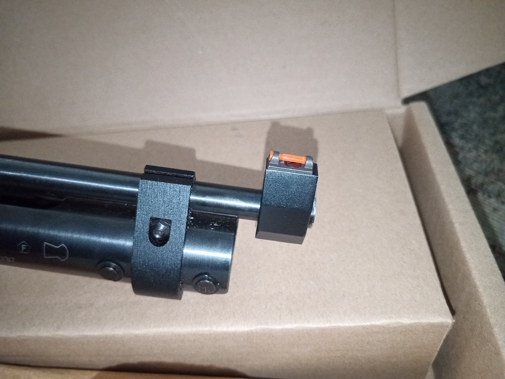

I got my "New" Izzy between Christmas and New Years. First thing I did was take a riffler file to the sharp corners on the grips and made a new front sight mount with a fiber optic. I made one for my original "Izzy" too.
