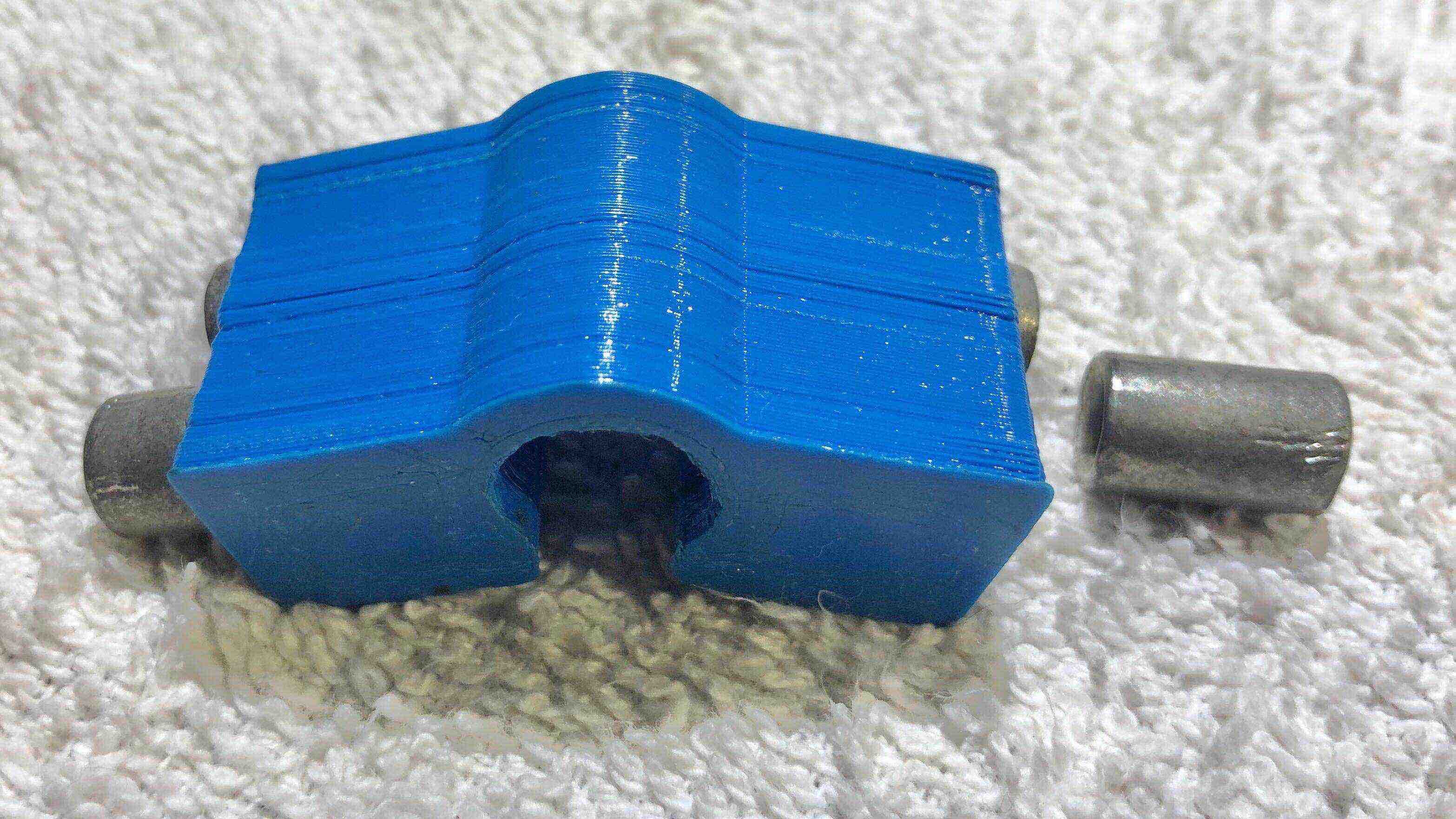

Early on I bought two of Andrew Berryhill's 3D printed barrel weight items, one each for my AP and FP; he can make them in a colour of your choice and of a diameter to suit your pistol.
The weight comes from up to four .38 wadcutter projectiles inserted in sockets in the fittings. The beauty of the device is that it is very easy to clip on and off the barrel (won’t mark it) and the weight can be varied on the fly if the pills are not pushed too far into the holder. Also, the device can be placed anywhere along the barrel - I use them up against the front sights to reduce muzzle movement, at least initially until I settle down. Especially effective of FP owing to the long barrel.
