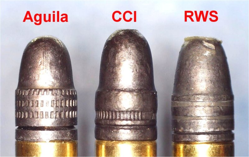

I'll have to experiment some more, but it may also have to do with the different bullet shapes between brands. I don't have a photo (yet) of the different free pistol options, but here is a picture of a couple brands the college team I help coach uses:
The full diameter portion of the RWS bullet starts further back than on the other two, so it may not engage the rifling and shave bits of lead off to hinder feeding.
