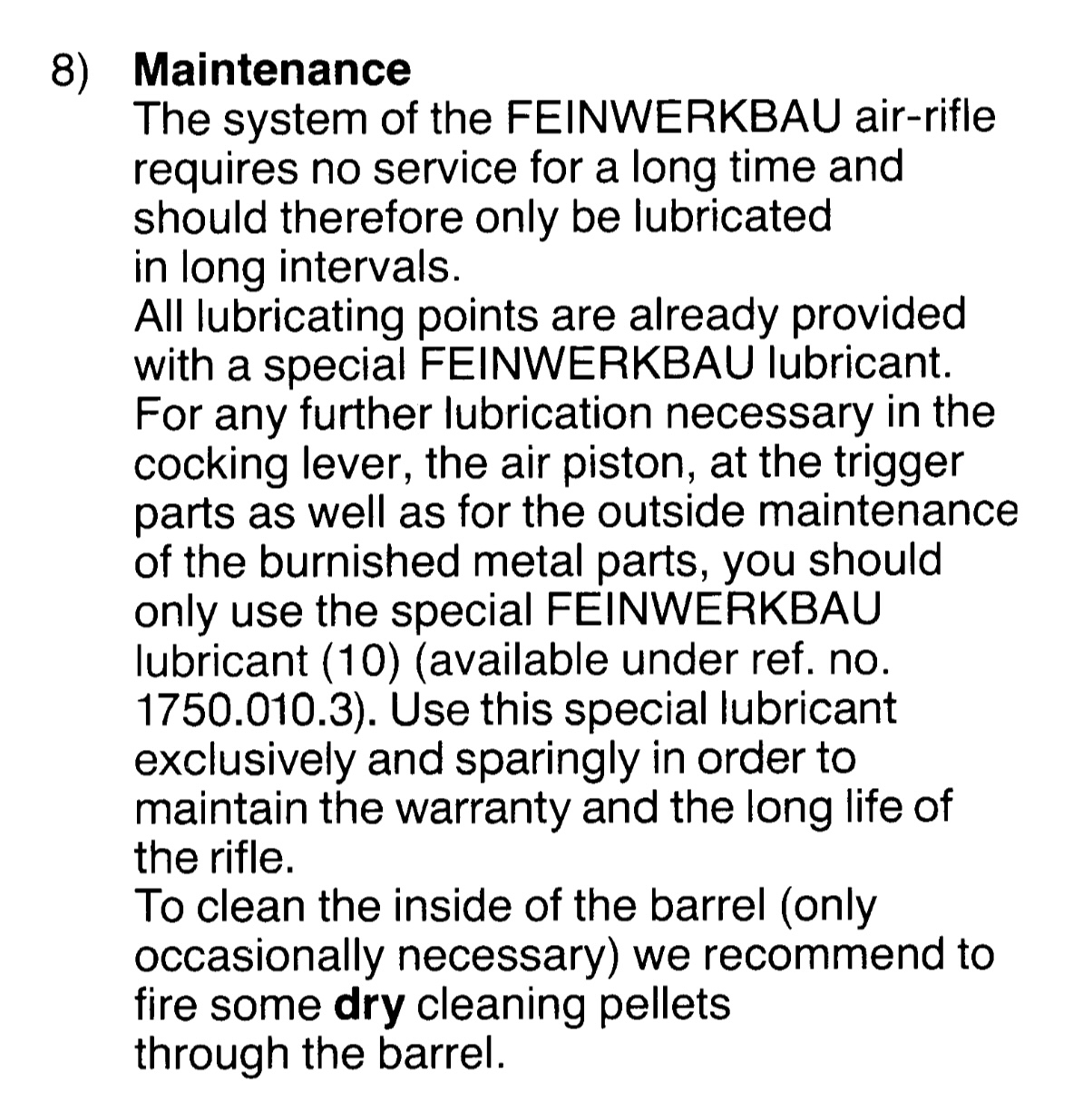

I am not an Olympic shooter.
I have been shooting firearms and air arms since I was 8 years old (70 years).
Last year I bought a FWB601 to replace my 300S.
The manual for the 601 is very explicit about barrel maintenance.
I suspect other manufacturers of high grade air rifles echo their thoughts.
