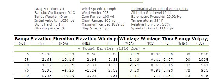

Thanks for the help, I found this chart and I am going to use 6” above a bullseye at 25 yards and bank on a 6-7” drop at 100yds.

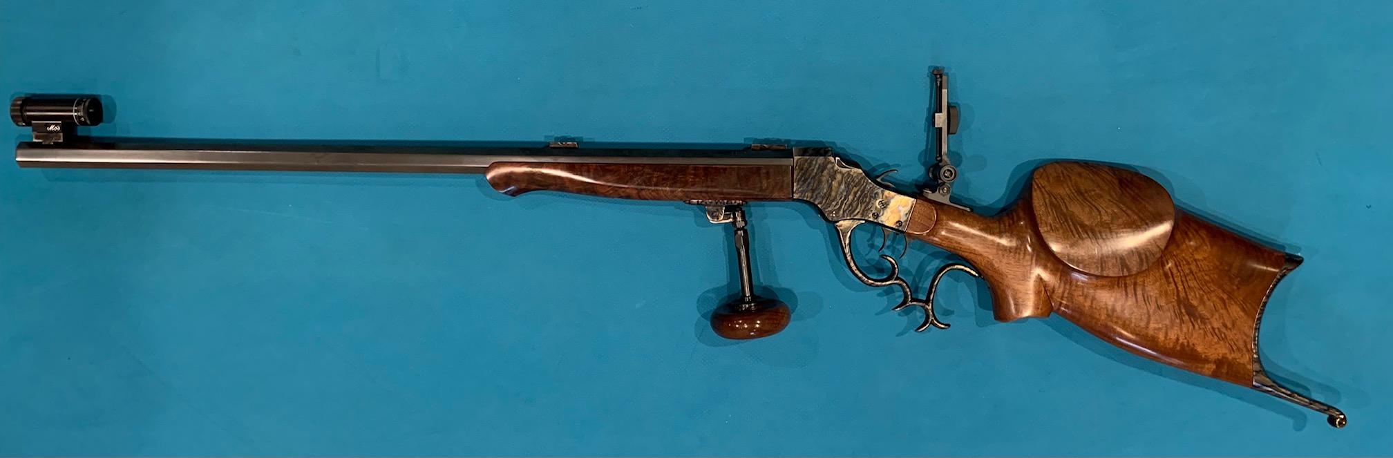

Also I attached a picture of the type of CPA rifle I am sighting in

Steven's 44 1/2?
Pope barrel, I assume.

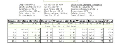

See this:

This has been very interesting to me, when I first thought of it I tried to remember from when I was a kid if a .22 dropped 8 or 10” @ 100 yard
The reply’s and the chart showed my memory is not that good. But looking at the chart that says there is about 7” different between 25 and 100, why wouldn’t holding that high at the shorter distance drop that much at 100?
What am I missing?
To answer the other questions, the rifle is a CPA 44 1/2 action with a Pope style stock and lever with a full octagon 28” barrel with a MO’s 22mm front globe and Baldwin midrange rear sight with a 29” sight radius

Beautiful rifle!!!
Martin H. added a key detail you didn't mention in your description.
Sight height is important as it determines the angular difference between the bore and the sight line.
From the photo, is it about 35mm center to center?
