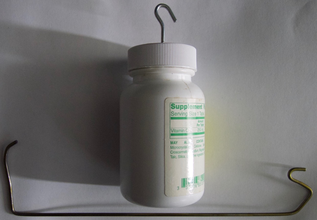

Here's my "work of art"........ I was going to put a piece of shrink tube on the hook - but hey, who go crazy.

Except for the two-tins-of-pellets approach, this whole conversation is quite baffling. Nobody needs to know what their trigger pull is, nobody. All that's needed - and I'd risk saying all that anybody should want - is to know it's legal by a large enough margin to pass any equipment check.
I watched a shooter score what would have medaled until the post-match check came up short. He "knew" his trigger was 505 grams... until it wasn't. This device weighs 530 grams, confirmed twice on different lab scales. If my trigger can lift it without discharging, I know I don't have to think about any match official or any sloppy procedure. And really, who can feel the difference between 530 and barely legal under match conditions?
An empty vitamin bottle and a piece of hanger - free. 18 or so ounces of #9 shot - pennies. The peace of mind that comes from full confidence in your trigger being legal - priceless.
