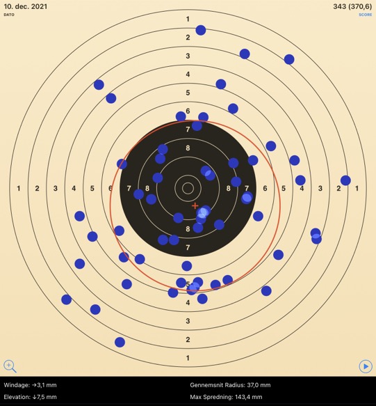

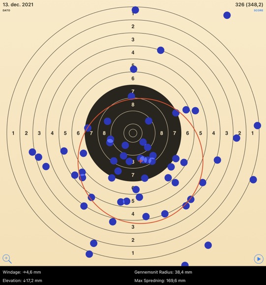

Hi,
I am a former archer, but an injury a couple of years ago has made it impossible for me to continue to shoot with a compound bow.
But I miss target practice, and since I always had a fascination for pistol shooting, 10m AP seems like a good match.
I have set up an 10m indoor range and tried to shoot a 10x6 series a couple of times. The results are posted below.
If You see something obvious with my shooting feel free to comment - I am here to learn!
Right now I am shooting with a HW40 and as the results show, it shoots much better than me at this stage. When I outgrow the HW40 I will probably buy a Walter LP2 or Steyr P11.
My ambition is to comped at a national level without embarrassing myself in 2-3. This means scoring at least 500/600.
It could also be fun to participate in an international event sometime in the future.
I will try to post whenever I feel like I have made significant progress.
Best regards
fc60

Regarding your groups, they should shrink in size the more you practice and build up your arm and upper body strength.

Hurtigpelikan wrote: Mon Dec 13, 2021 2:47 pm If You see something obvious with my shooting feel free to comment - I am here to learn!
I'm in week 11 with 10mAP - your targets look familiar and mine were very similar. Lots of decent information here so keep you eyes and ears open. I also set up a small range at home, but I'm also told it's important to vary where you shoot.
My focus at the beginning was fine tuning the grip, and not over-holding. One of the best pieces of advice I got from here is the idea of "don't think about the shot - but rather think about the components that make up a good shot". Sounds benign, but I think having the same "mental checklist" with every shot is REALLY important.
Good luck - here's one of my 10X1's from week 11. I call it "the outliers moving toward the infield". Clearly still jerking the trigger - but I'm working on it.

I'm not so sure you are jerking the trigger. A jerked trigger usually goes into an 8 o'clock area, not high right. You might be gripping at the moment of trigger release, that usually will go up and right. Watching your front sight when dry firing is the key to finding if you are doing something that disrupts your hold at the moment of trigger release. If you don't think you are gripping, perhaps all you need is a sight adjustment. If all your groups look like that, coming down would eliminate your 7s.
Posts: 1231
Re: New to 10m (and AP in general)
Hurtigpelikan,
Your targets show that you are all over the place. It's pretty common in new shooters so don't worry too much about it.
Without seeing you shoot, it's very difficult to diagnose the problem (probably problems...).
So let's start with the basics.
1- Where is your focus? Target, front sight, rear sight?
It must be on the front sight, like this:
2- What happens to the front sight when you break the shot? Does it move?
3- This is just a guess, but you are probably gripping the pistol too hard, trying to make it stop wobbling.
This is what I would suggest:
- Get a chair and a table, and something you can rest the pistol on, that allows you to shot while sitting strait. Rest only the bottom of the grip, and nothing else. This takes the weight of the pistol (mostly...) out of the equation, and let's you focus on sights and trigger.
- Focus on a good sight picture as the one above. The rear sight will be a little blurry, and the target a lot blurry.
- Squeeze the trigger gently. Apply pressure in a continuous manner, and resist the temptation to smash it when the sights are align.
- Finally, find a club in your area. You can learn a bit online, but nothing close to what someone watching you shot can tell...
Hope this helps

Excellent advice from both brent375hh and rmca, and I'm sure others will add to this.
Hurtigpelikan..............see what I mean !

Hello Hurtipelikan, You've been given great advice. I'd like to add that Dry Fire is incredibly important
for your training; I recommend you do more of that than lobbing pellets at a target. It is easy to dry fire
the HW 40, all you need do is lift the upper cocking section until you hear the trigger reset then lower
the upper section into firing position. then gently, smoothly pull the trigger.
