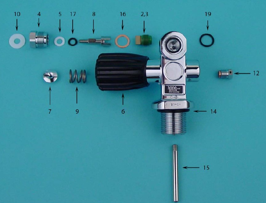

Posts: 1718
Re: Unfastening the very tightly screwed PCP Cylinder
Its the seal that does the work, you do not have to close the valve very tight.
Most tank valves have a built in shear drive.(part 8 in dia)
If its locked up tight, using force may break the shear.
You can remove the handle to turn valve stem (part 23) to release the air.
If that does not work then just crack the over pressure valve (part 12)
and allow the bottle to empty over a couple of days.
