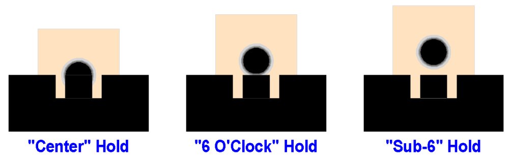

Posts: 1719
Re: Better groups on blank target
Jon Eulette wrote: Mon Sep 20, 2021 11:45 pm .. Also if you decide to shoot sub 6 hold watch for vertical stringing. It’s common. Most average shooters don’t do well with sub 6.
Jon
The vertical stringing usually occurs when the using a 6 hold or sub 6 that is too close to the black, the sight and black tend to mend giving you a vertical string.
"Would this be a sign that one perhaps should try (what I seem to remember being called) a "deep sub 6 o"clock" hold, that is with your sights down in the region of the 4-3 ring?'
When thinking about sub 6 hold do not think about 4-3 ring (lookoing at target).
Use sight picture with equal light gaps Side bars and top bar equal).
Sight Pictures.jpg (28.15 KiB) Viewed 4799 times

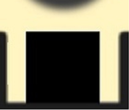

Posts: 1719
porkchop wrote: Wed Sep 22, 2021 7:40 pm " Also if you decide to shoot sub 6 hold watch for vertical stringing. It’s common. Most average shooters don’t do well with sub 6.
I will say it again, vertical stringing is usually trying to hold too close to the black.
Most average shooters have a 6 o'clock hold rather than sub-6.
Try increasing the light gaps to equal gaps.
Try this as a ideal sight picture.
Foresight 70% of apparent target black.
Foresight ratio 2/1 ie. half width light each side of foresight.
Foresight height adjusted to appear as a square.
Equal light gaps at sides and above foresight.
sight 70%.jpg (10.56 KiB) Viewed 4569 times
The secret is focusing on the square.
