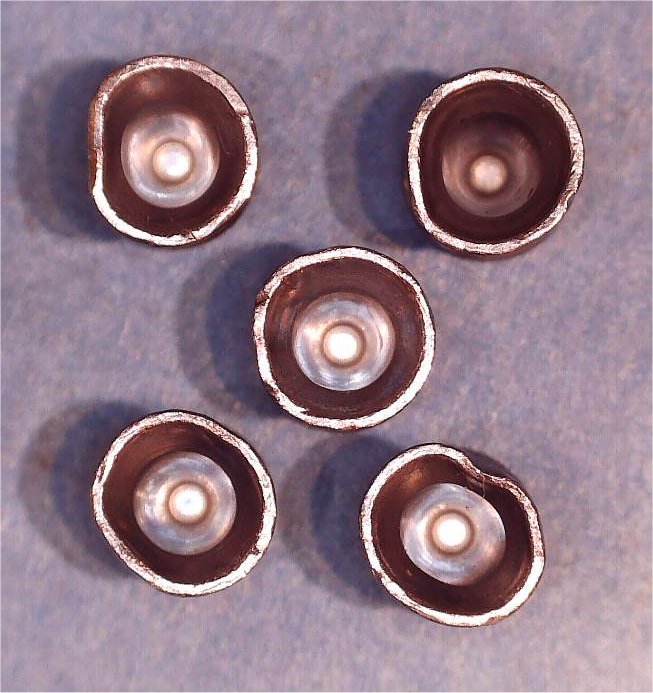

RWS Basic pellets have worked very well for me for quite a few years. The college team I help coach goes through about 60K of them a year. HOWEVER, they are still soft lead, bulk packed in a metal cans that get drop kicked across the Atlantic. It's one major reason I won't buy the 300 pellet cans. The extra space allows the pellets to bang around & get damaged a lot more easily.

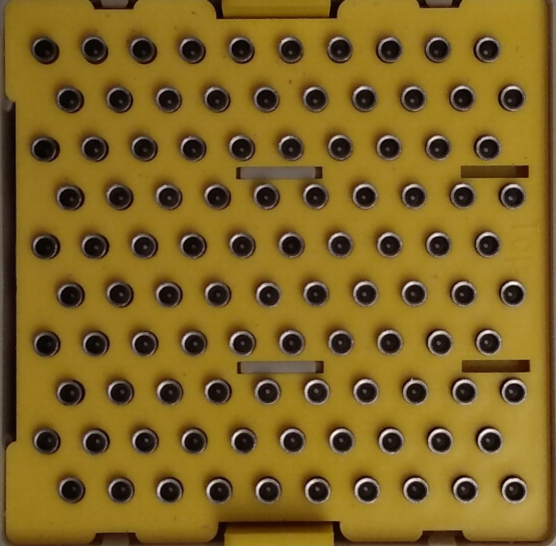

I just opened a new can of Basics earlier this week. I always use one of the plastic spring operated pellet boxes that you load with 100 pellets. One of the advantages is that it's pretty easy to examine the pellets for damaged skirts, although usually, I don't have to bother. The 1st 100 rounds I shot were fine. I loaded it today with another 100, from deeper in the can. I'm shooting a Steyr LP50, and if the pellets are deformed very much, the magazine won't load smoothly, which how I found the first bad one. I looked more closely, and found 4 more:

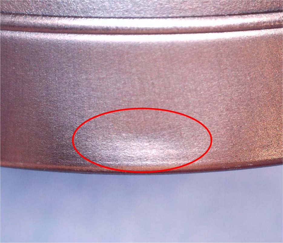

The middle one is probably OK, but the rest look pretty suspect and probably won't load smoothly in the LP50. I examined the can, and sure enough, there was a dent in the side, about 1 mm deep:
Even if you pay 3 times as much for 500 pellets tins, you will always be at the mercy of shipping damage like this. Individually packed pellets are REALLY expensive, but if you are going to shoot in an important match with bulk pellets from a can, I'd do two things:
1) Use pellets from a can with no visible dents
2) Use one of the plastic pellet boxes, and take a good close look the skirts for signs of damage.

This was the first time I've run into damage like this with Basics. I buy them in the 10 can sleeves, which is more subject to shipping damage getting from Texas to Massachusetts that the cases we buy for the team.

You don’t have to discard those pellets. When they are in the magazine, use a little force with the tip of a Bic pen, it will open the skirts of damaged pellets.

Throw them in the garbage. They're 1 1/2-cents each. Why force a damaged metal object into a $2k precision machine?

I agree with Atomicgal 100% re biffing the damaged pellets... the cost is not even worth the thought process..!! But if you get a crap score with a damaged pellet that surely is something to be getting inside your head..(if you are shooting for score that is) If you are just plinking around then no issue either way.
If you are getting damaged pellets I would seriously consider changing them to another brand or grade. As Atomicgal suggested also why put an expensive pistol in jeopardy of having a pellet jam..

The problem in my case was clearly shipping damage, not the quality of the pellets. Shipping from Europe to the USA can be a rough trip, independent of the cost of the pellets, unless you want to spend for individually packed pellets instead of tins.

There was a visible dent in the side of the can, maybe a mm deep. I buy RWS Basics by the case the the team I help coach, and they come well packed. I don't recall having seeing any bad ones in over 200,000 pellets, but most of my students aren't terribly observant... The ones that got dented were purchased in a sleeve of 10, or possibly loose tins. It could easily have been damaged in shipping in the US, although the guy I buy from is usually very careful to pack stuff well.

Seat those soft lead pellets into a round barrel and they will become a lot rounder. Hit them with 800+ psi of air pressure and they will likely conform to the barrel just like "perfect" ones. Test those next time you clamp the gun in a vice and you will be surprised how little difference it makes on a pistol target. On the other hand, if I was a rifle shooter that could shoot 600 decimal or higher, I would discard them. If you really want to see something, intentionally put a pellet in backwards when group testing. You will be very surprised how little difference in impact point that causes.
