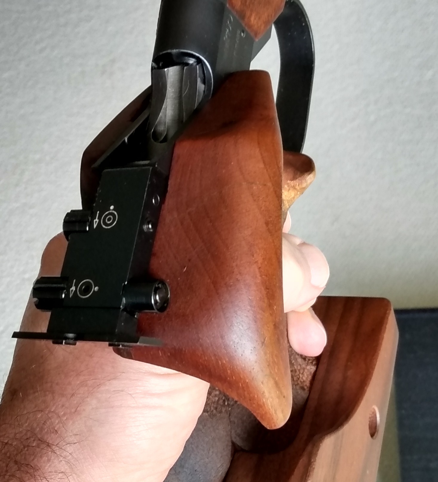

So I got in a nice used Hammerli FP60 and the top right hand grip wing was broke in shipping. Going to file Fedex claim on it am wondering how to fix this if I get screwed. I've been a fairly decent wood worker for 40+yrs and this is a really clean pretty break. Couldn't ask for a better break. Am wondering if this has happened before ( seems like it should have, kinda fragile spot) and how other people handled it. Don't know if I should used a fast epoxy or gorilla cryo glue for wood. Fixed a guys chair last month, and did a good job and strengthened joint w/dowels. Thinking after I glue it and sets a day or two line it up on the drill press and two small dowels epoxied in might do the trick.
thanks,
Jay

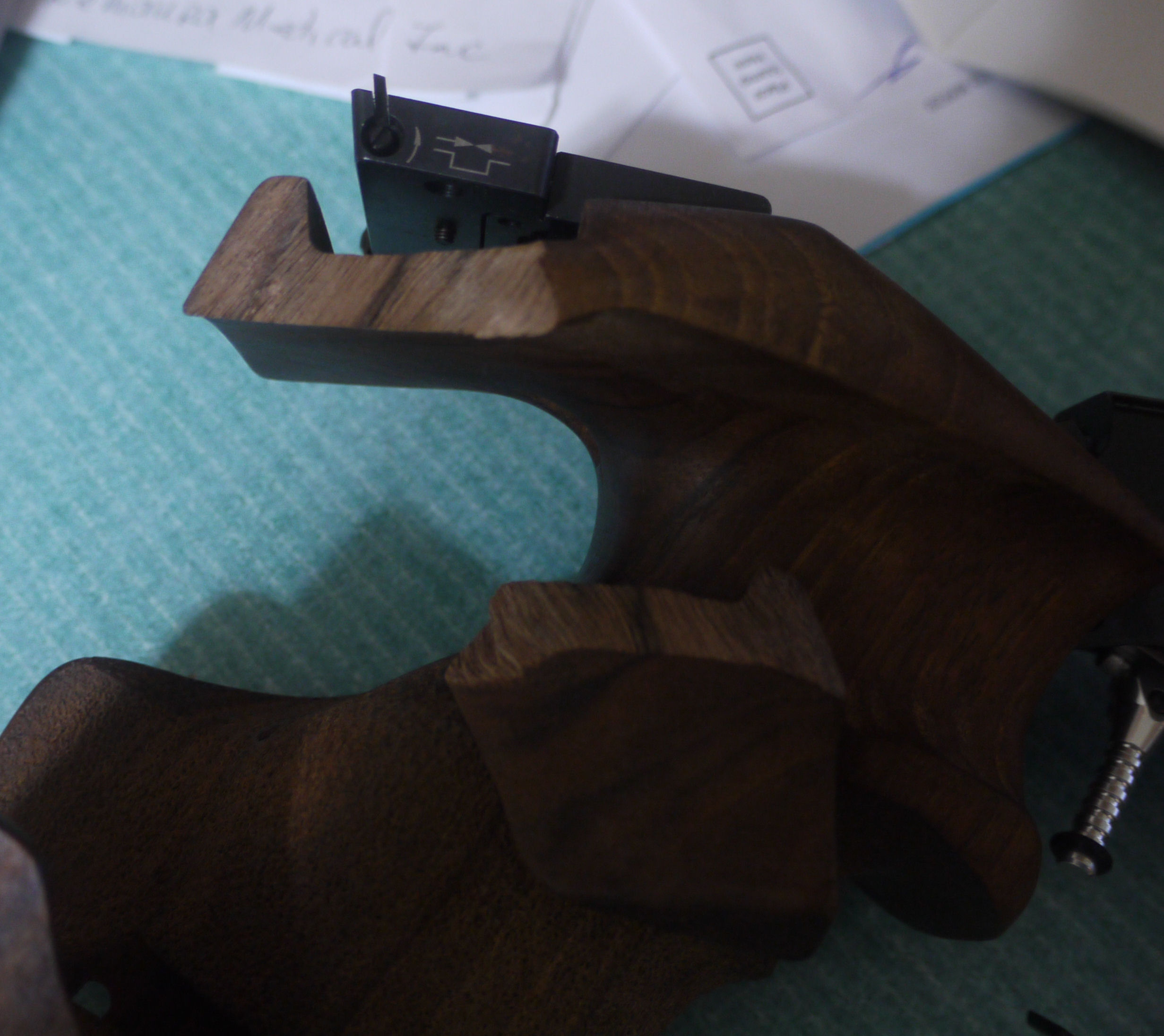

I had the exact same break. I used two steel dowels, but I had the use some smaller than the holes I drilled to get it to line up. It's hard to drill them in perfect alignment in both parts. I used Acraglass bedding gel. You can see a faint hairline where it broke, but it has been solid as a rock for 26 years.
I am sure a real woodworker can offer up a better solution for adhesives, but if you ever got glass bedding where you don't want it, you learn how strong it is.

My ugly, but strong, fix is shown as the non recommended way for the fix. No matter how you slice it, it can't be worse than this.
