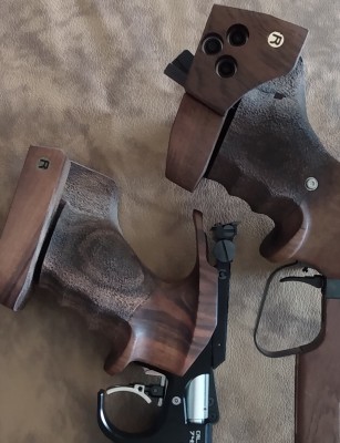

My Rink grips for my LP10 arrived today. I was very anxious that they would not be the same size as the ones I received for my Toz. They are exactly the same fit, with the exception of being ISSF AP compliant in size.
I couldn't be happier. It's like shooting a whole different, and better gun.
