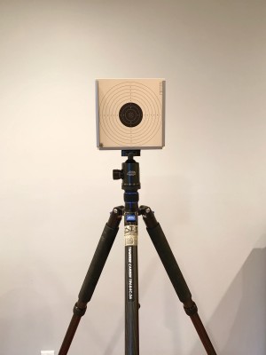

Ok, here is what I did.
I took about a quarter of a pound of duct seal and added it in different places in the trap to deaden the noise. I added a large chunk at the bottom of the plate so the plate would angle downward. This didn’t really work out to direct the pellets down, but it did reduced the noise significantly. I then added smaller pieces of duct seal to different areas of the trap to further reduce the noise. It works, but it’s still far from silent.
Next I used epoxy to attach an acra Swiss plate to the bottom of the trap. Now I can use my tripod as a lightweight target stand that is very portable. Just what I wanted.

DWood wrote: Fri Jan 22, 2021 5:47 pm Ok, here is what I did.
This tripod idea is brilliant. I will steal it for my holders. Not gonna use my Arca Swiss head though, to precious!
