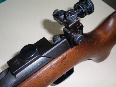

BRNO manufactured a rear aperture-style sight for the Mod 4. And, yes, the receiver dovetail is non-standard (I *think* it is 16mm). In any event, I have two BRNO Mod 4's, both with this sight setup. Attached is a pic that gives a general idea as to what it looks like. The sight slides onto the dovetail and is fixed in place using the thumbscrew. If you look closely at the dovetail, you'll see a small dimple on top - this is what locates the thumbscrew.
From the factory, it came with a fixed aperture. With the correct thread adapter, you can mount any of the modern adjustable iris apertures (Anschutz, Gehmann, etc.).
Hope this helps and enjoy that Mod 4. They're great shooting rifles, needless to say!
