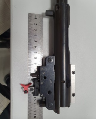

See sttached the receiver size (mm)
I'm not sure that it fit well on the stock gap.
On the other hand there is a lack of drawings to check measurements and it is hard to invest 1500$ if you are not very sure.

Posts: 2083
Re: Walther KKM-GX1 upgrade
Devi,
I'd remembered the Walter had a long trigger mechanism. If you are supporting the barrel, and the receiver does not touch the stock, it seems possible to make a bigger hole for the trigger. The new KK500 fits the EC stock, and that also has a long trigger.
Send me a PM with your email and I can send you pics of my Gemini buttplate. It is fitted to a Gemini stock. I'm sure I've seen one on a Walther GX-1 so it's just a question of drilling holes in the right places to bolt it onto your Walther.

I don't think the OP was talking about epoxy bedding the action. Instead he meant his Walther action didn't fit an EC stock properly due to the size of the trigger mechanism and the position of the rear screw.

Yes the main problem was the adjust of trigger size in the stock.
Finally I change gx1 with a Anschutz 54 more polivalent and aftermarket stocks.
