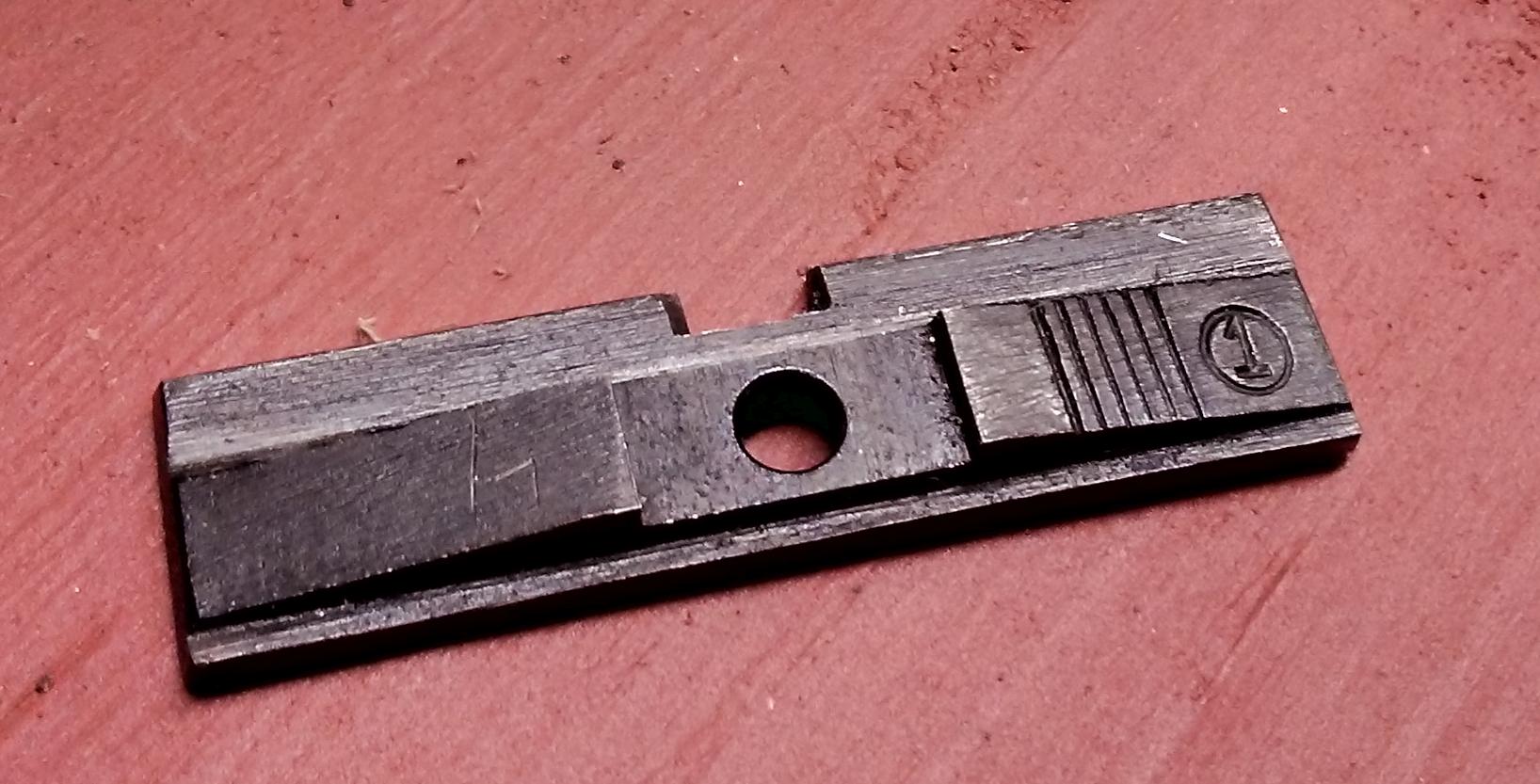

This is a long shot, but I'm wondering if anyone knows of a source for rear sight blades for the MC-55. I haven't found any posts on the topic after searching for some time.
I bought my MC-55 used, with only the pistol and none of the tools or replacement parts shown in the manual. Unfortunately the rear-sight notch was crudely widened at some point and it's too wide for my needs. The pistol shoots superbly and I find it hard to understand how or why the rest of the package - case, tools, parts, manual - would have been lost or discarded. But that's a rant for another time.
I've thought of filling in the rear sight notch and re-cutting it to the width I want, but how to fill it in? I know guys that can do really fine TIG-welding but if something goes wrong I will be in a real pickle.
I have a feeling that in the end I might have to hand-file a replacement rear sight blade, either from metal or maybe acrylic(?). It's a fairly complex shape but I think I could make it. Unless there is a supply of replacements somewhere.....

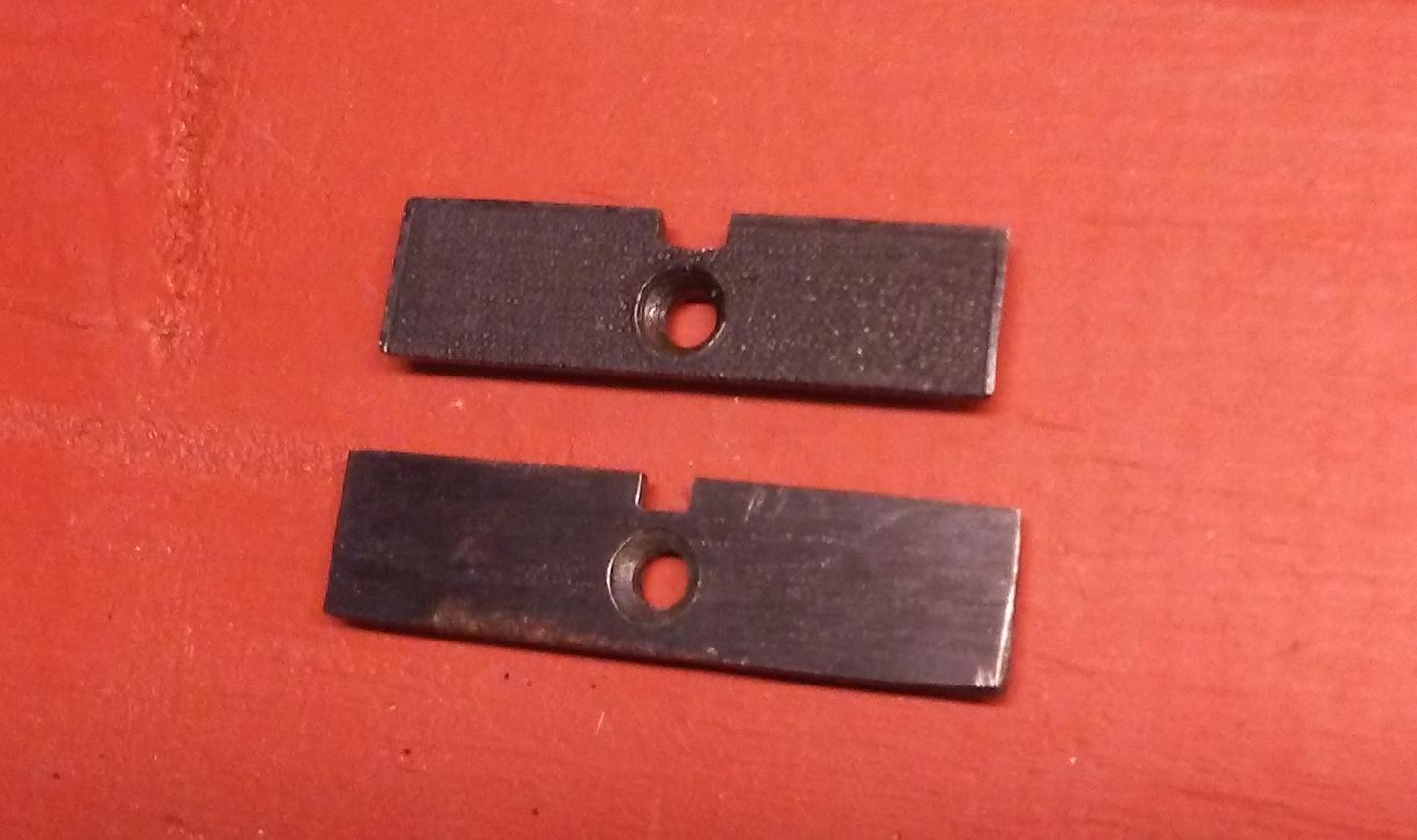

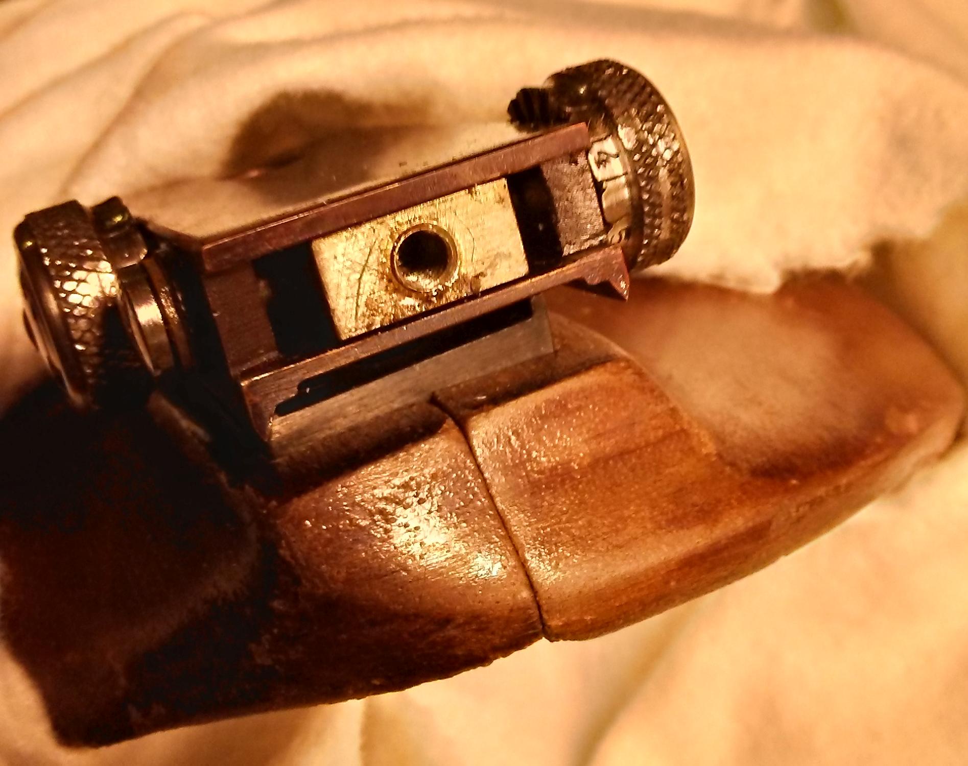

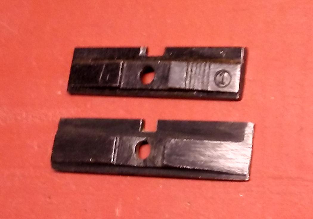

I appreciate the replies. I have posted a couple photos.
The MTs-55-1 rear sight plate is not a flat piece of metal. Turning it over and cutting another slot is not an option, as there isn't enough metal.
The side of the plate that contacts the sight has a transverse ridge with a central slot that fits snugly over the mount that slides left-right. The ridge and slot are cut such that the plate is not flush against the sight body itself, permitting left-right movement. It is quite a complicated design and not one that I plan to reproduce exactly !
A flat plate screwed on directly would bind against the sight body and impede windage adjustment, so a spacer would be needed. If the plate shows signs of wanting to rotate, a couple of little pegs soldered/screwed onto the plate beside the hole would maintain alignment.
It would be nice to have a spare screw or two... the thread is incredibly fine. I'm not sure my local hobby shop carries anything similar.
I do have an ample supply of brass sheeting, brass screws, files, hacksaw blades, vises, etc., etc. , so I guess I will have to just dive in...

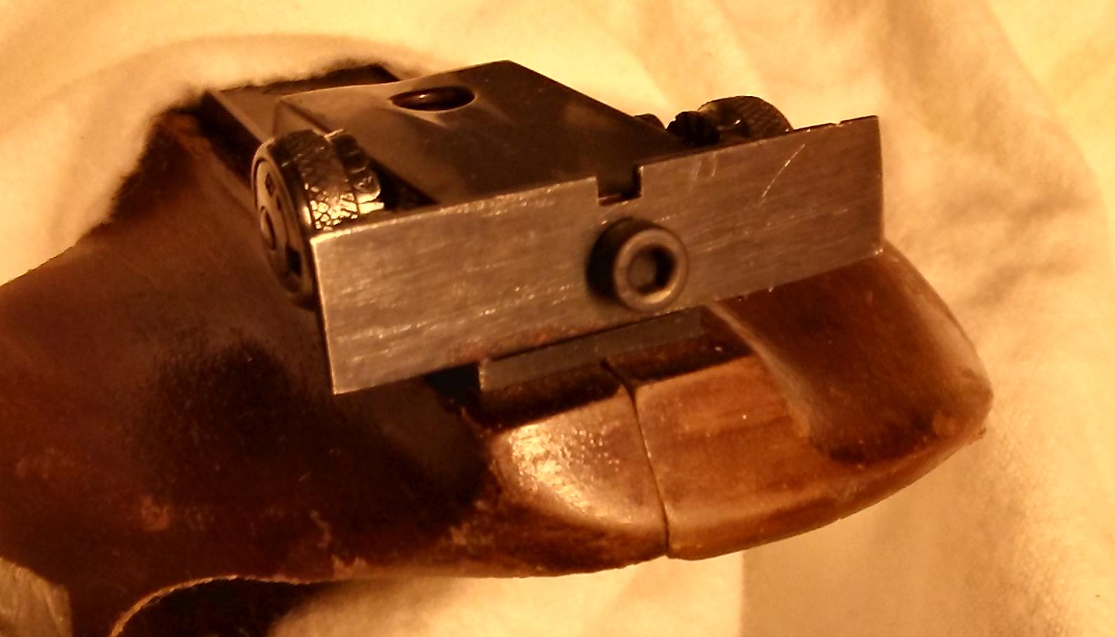

As regards gluing and soldering, I prefer not risking damage or destruction of the original part, seeing as they are so hard to find. Anyway, I spent the afternoon filing an old piece of steel, blued it, and now own a 0.10-inch gap rear sight. The old one was 0.15-inch.
I read somewhere (Igor's toz35 blog, maybe?) that a Steyr LP10 rear sight assembly can be readily fit onto the MTs55. Seeing as I have an LP10, I am going to try that out as well.
