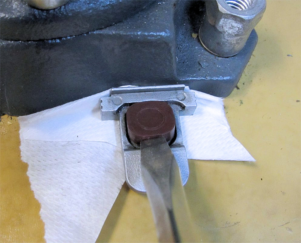

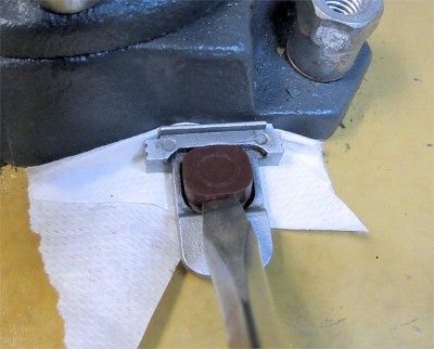

Posts: 3572
Re: Oiling Top Round in Semi-Auto Magazines?
My daughter's is an LGI buffer, but mine appears to be original. I'll shoot with my daughter's a few more times to be sure, but if I don't have any issues, I'll install a new LGI buffer.
Does anyone have an slick techniques for installing them? I've done about a half dozen for myself & the team I help coach, but I always end up chewing up one of the tabs that hold them in place. I've never had a problem with one falling out from the damage, but it's annoying. I put some padding behind the block, and butt it up against the base of my bench vice. I get the first tab in its slot, and then use a large screwdriver to compress the buffer and pop the second tab down & into place.
I tried making a clamp to compress them enough to pop them into place. I got that to work once, but the clamp keeps slipping and I need to re-think the geometry.
-TT-
Posts: 411
Post by -TT- »
Larry's old Benelli guide had a photo attached showing how to install his buffer, I'll try to find it tomorrow.
What I recall is that it showed exactly what yours shows, but pressing the tab on the opposite side - i.e. at the "top"
Posts: 3572
Hmm... It's possible that if you work from the other side, you can pry it into place more easily.
I'd be very curious to see a copy of Larry's "Benelli Guide". Can you scan it? This is the first I've heard of its existence, despite having bought lots of Benelli parts from him & visited his shop countless times.
Thanks!
deadeyedick
Posts: 1204
Post by deadeyedick »
I can’t remember how my Benelli buffer was installed but my FAS 602 and 607 had the metal backing with two tabs that through its design was prone to failure.
I sourced an almost identical material and made a new buffer that was a better fit and then cleaned all parts with acetone and applied contact cement.
It worked perfectly and even after 1000 rounds was showing no signs of wear or signs of coming loose.
I got rid of the metal retainer which usually broke after relatively little use because of work hardening, increased the surface area and made future replacement easier...and cheaper.
