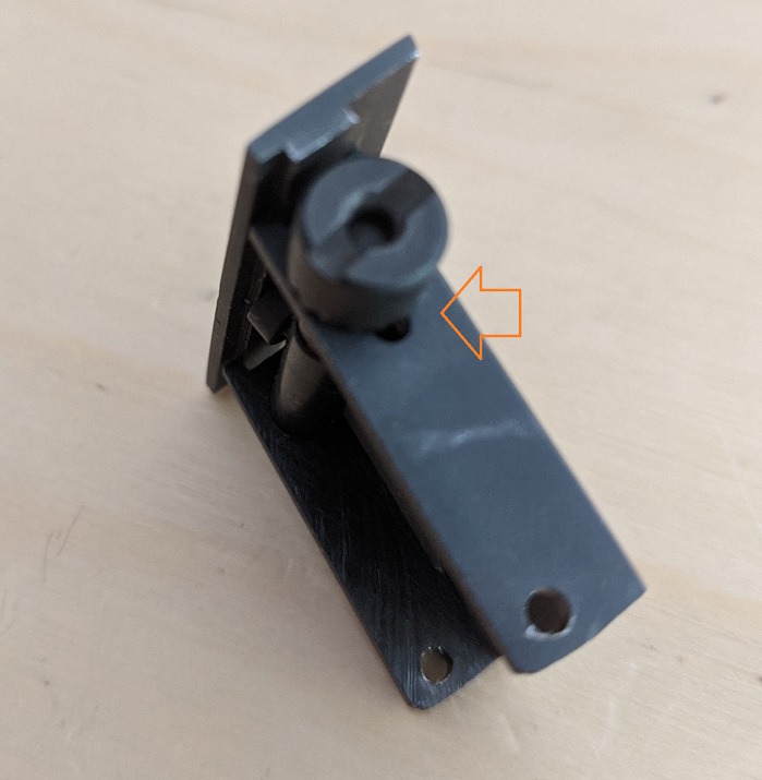

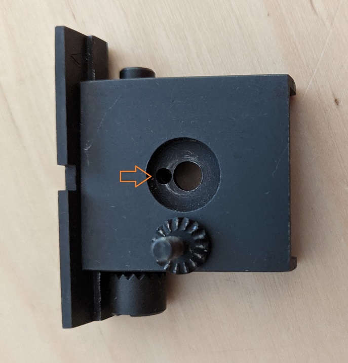

I'm reinstalling the rear sight onto my MP95E Benelli. It's an older model pistol and the sight has been off for some time. I've collected all the parts and cannot figure out what is missing from the click detents.
Here are two photos showing the ~1.5mm holes (see arrows) under the adjusters for both elevation and windage. But, they are just holes - my newer MP90S has little bumps in these spots. As a result, there are no detent clicks, only friction. There is nothing else indicated on the MP95 exploded parts diagram.
I thought maybe a tiny ball bearing rides there, but the adjusters ride poorly on it (perhaps my smallest bb is too large at 2.5mm). And, there is practically nothing to keep any bearing from flying out.
Anyone have a similar era MP95 to tell me what mine is missing?

Are the holes "blind"; or, are they drilled straight thru?

Both are through holes, 1.5mm. I will try a 2mm bb.

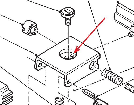

Very strange these are not shown on the diagram, if so. I am looking at the one in the manual that came with the gun, in addition to other sources.

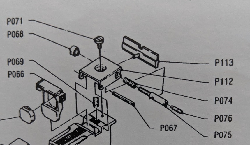

The holes are for the spring and tiny ball. For vertical adjustment spring p/n is P069, for horizontal it is P074. I don't see the balls on the schematics diagram, but they are there.

The holes are definitely 1.5mm. A #52 drill bit is a no-go, a #53 is a go. #53 is exactly 1.5mm, so I would be quite surprised if a 1.5mm bb will ride and not fall through! I will experiment.
Regarding springs 069P and 074P, these are not detent springs. They're much larger, and in a different location. 074P wraps around the windage stud well inside the radius of the detent hole. And 069P rests in a pocket in the frame several mm in front of the elevation screw. They provide tension of course, but they do not contact the detents.

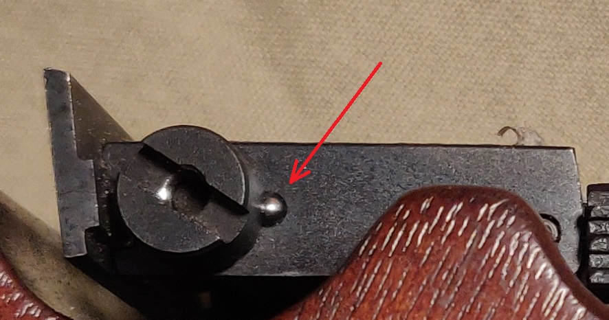

Sorry, you are right, 069P and 074P are not the springs pushing the balls. I was looking at the bad scan of a later model diagram, apparently. This is how horizontal adjustment ball looks like on MP 95e, date code BF i.e. 1995 vintage. Vertical adjustment ball looks the same but it is completely under the screw and not visible without disassembly. It is interesting that vertical adjustment ball is actually shown on the diagram, but no p/n is given.

Ok, the issue is settled, at least for my pistol: 2mm.
  • 1.5mm - falls through hole
  • 2.5mm - sits too high, falls out
  • 2.0mm - nestles in like a coddled egg
Photo looks exactly like nik365's, below. I plan to use a dot of threadlocker to keep the parts from departing the seating hole.
