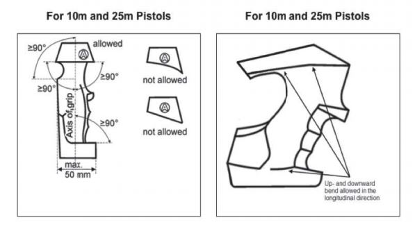

My weekend project is to make a wider and longer palm shelf for my LP10.
Hopefully a slightly wider palm shelf will give me a better three point lever anchor at bottom of my palm to loosen up my grip.
Is there any ISSF stipulation on the width of palm shelf?

Air Pistol 420 x 200 x 50
So max thickness is 50mm.

Got it. Max width total 50mm.

Re: Palm shelf width
Post by greentangerine »
The dimensions are explained in the rule/diagrams under 8.13 in the ISSF rulebook (2017).
Post by Ricardo »
The 5 cm measurement on the diagram is not specifically the width of the palm shelf; rather, it's the width of the entire grip. It may be possible to shave off some wood from the top of the left side (for a RH shooter), which looks a little cantilevered outwards. That would allow for a wider shelf, it seems.
Posts: 1231
Comply with the drawing from the rule book

When it comes to a longer palm shelf there are dozens of posts about how far back towards the arm is legal. There seems to be some agreement that the wrinkle line at the base of the hand is the standard, but that seems to me to vary among people in relation to the joint itself. I've been studying photos of shooters at ISSF events and I'm pretty sure that many have grips that extend to the styloid process of the ulna -the bumpy thing on the outside of the wrist area, where we wear wristwatches. This is like beating a dead horse, I know, but I think it's a zombie horse.
Posts: 1718
The grip should give no support to the wrist.
So the pub test is to fit the pistol in your hand and in shooting position can you move/tilt the pistol both up and down at the wrist.
It still has to fit the box.
