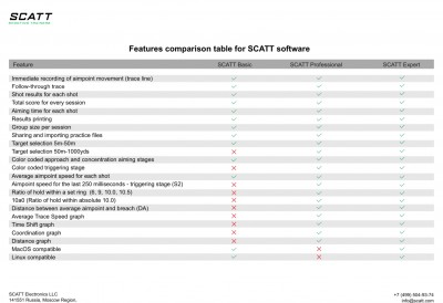

For Mac you need the expert software.

Like Th said above, just download the SCATT Expert software for Mac OS from the SCATT web site here:
https://www.scatt.com/downloads/
Nothing to it. I've been using an MX-02 since about 2014 on my MacBook. Previously had to use parallels and windows, but the Expert program is Mac native.
