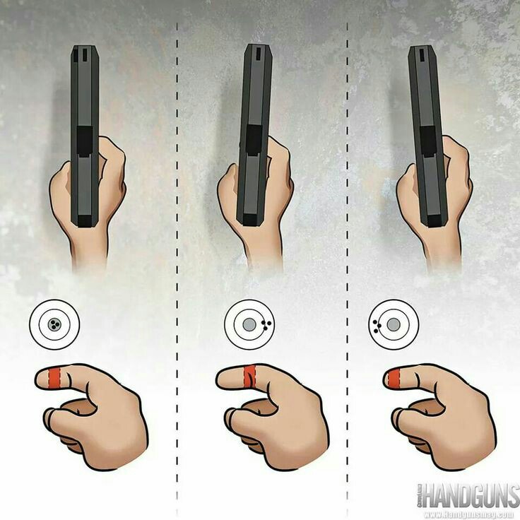

As others have said, as a starting point you should do this:
If you can shoot ten's consistently, any other way, more power to you.
Hope this helps
