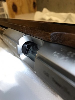

A friend of mine recently received a new smallbore rifle. It came, as usual with and acceptable test card. It also came with a chamber that would be impossible to actually chamber a round (or even close the bolt). See attachment. An extrusion from the chamber into the breach. The extrusion was not loose, but fixed and impossible to remove. The dealer replaced the rifle, have not heard from the manufacturer.

One also had to question how that rifle passed proof, something not done in house, but by an independent body.
It looks as if someone put a screwdriver into the chamber. I wonder whether the barrel chamber is as damaged as the insert that forms the face.

It's an Anschutz 54.30.

Tim is correct on the make of rifle. It was custom ordered in a 1907 stock.
Doesn't it strike anyone else as somewhat fraudulent that a test card came with a rifle that could not have been fired?
Geez, they could not have even but the bolt in the rifle and closed it.

Or how it passed proof.
It's possible the damage occurred after assembly.

Perhaps the damage was done after the factory inspection and test target.

James Storm wrote: Tue Dec 31, 2019 9:30 pm Perhaps the damage was done after the factory inspection and test target.
I agree with James on this. I believe its far more likely that the test card was fired at the factory and then the rifle was sent for proof, which it probably failed (remember proofing involves firing a round much stronger than standard ammo to prove its safe). The error was probably not checking the firearms that had been returned had all passed proof, but you're right it should never have been delivered to a customer. (It does also look like a foreign object is stuck in the breach which could have happened at proof). I cant imagine a company like Anschutz would risk their reputation sending out false test cards. I once had a firearm returned to me by a gunsmith after he had re-barrelled it and it had failed proof (headspace too tight) but they didn't tell him and he didn't check.
I also recently bought a long barrelled pistol that had a bulged barrel from brand new which must have happened at proof. I returned it and they fitted a new barrel, problem solved. Luckily for me I field stripped it the day I got it home to clean and noticed the damage. It might have been harder to prove if it had had been two or three months before I noticed the damage.
