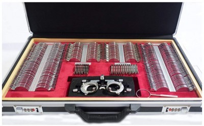

An option I am considering is to get a few trial lenses in the ballpark of my current prescription to experiment with (see https://www.ebay.com/itm/Metal-Rim-Tria ... 1125682200) and then get a lens done properly with the right setting.
Incidentally, the diameter of the trial lenses, seems to match closely what pistol frames use.
The problem with my optometrist is that I can't bring the pistol there; last time I brought a stick with sights at the right distance, but it was too much trouble. And in any case, the exam is indoor, with artificial light. I see more issues when shooting FP @50 yards, outdoor.
