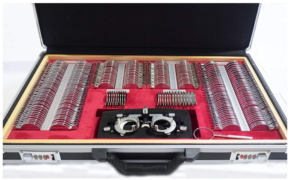

An option I am considering is to get a few trial lenses in the ballpark of my current prescription to experiment with (see https://www.ebay.com/itm/Metal-Rim-Tria ... 1125682200) and then get a lens done properly with the right setting.
Incidentally, the diameter of the trial lenses, seems to match closely what pistol frames use.

Leon, this is what I did. In my case I already know the old prescription and the direction in which my eyesight is getting worse, so I don't need the full set. I've got a couple of these in .25 steps from my current shooting prescription: https://www.ebay.com/itm/Metal-Rim-Tria ... 1125682200
