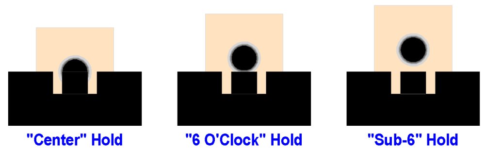

Posts: 1718
Re: Can anyone convince me to keep using center hold for 10m?
Sight Pictures.jpg (28.15 KiB) Viewed 7579 times
sight picture 70%.jpg (12.53 KiB) Viewed 7579 times

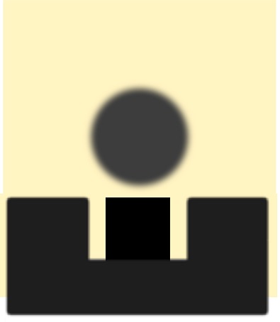

Posts: 3572
To maintain the maximum amount of symmetry in the sight picture, you also want to keep the size of the side gaps roughly equal to the gap below the black:
The brain & optical system love symmetry. Rather than thinking of the sights & targets as three separate moving pieces, you can train your brain & muscles to try to achieve the symmetrical image shown above. This off-loads your brain a bit

jblphoto
Posts: 48
Joined: Wed May 31, 2006 9:33 pm
Location: Nashville IL
Post by jblphoto »
GWHITE that’s the best graphic I’ve seen that explains why a sub six works. Thanks for posting it.

Post by Owl »
GWhite's schematic pictures, above in this thread, are excellent sight picture illustrations.
