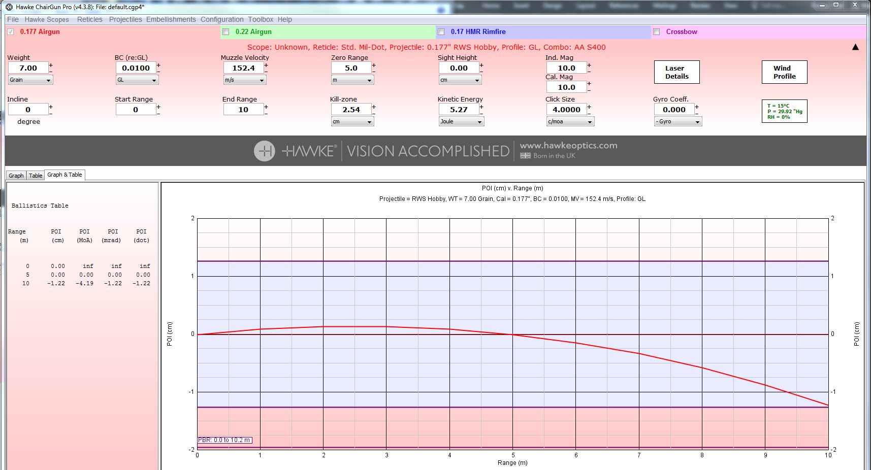

So i cheated and used the Hawke Optics software Chairgun Pro. Configured for RWS Hobby pellets shot at 500fps (152.4m/s) with a sight height guess of 1.27cm (0.5") and a 5m zero the POI at 10m is 0.5mm high. Almost a double zero at those distances assuming the sight height is correct...
If sight height is set to 0.0 with 5m zero the POI at 10m is -12.2mm. FWIW, I practice with my P8X (RWS Basic 7gr, 164.6m/s) at 7m with 42mm dia target then shoot standard 59.5mm targets at 10m and make no adjustments. When i plugged those numbers into Chairgun (zero at 7mm, 1.27cm sight height) the POI at 10m was 0.9mm low. I'm not good enough to notice.
I'm not sure about the sight height setting since this software is for shooting with scopes with parallel offsets where the desired outcome is generally POI = POA. Am i correct thinking that Sub 6 hold introduces an angular offset that should be constant when using correctly scaled targets at various distances. Thoughts? Angular offset might be affected by less bull blur at 5m & more blur at 10m resulting in lower POI at 10m...If sight height is set to 0.0 with 5m zero the POI at 10m is -12.2mm. FWIW, I practice with my P8X (RWS Basic 7gr, 164.6m/s) at 7m with 42mm dia target then shoot standard 59.5mm targets at 10m and make no adjustments. When i plugged those numbers into Chairgun (zero at 7mm, 1.27cm sight height) the POI at 10m was 0.9mm low. I'm not good enough to notice.

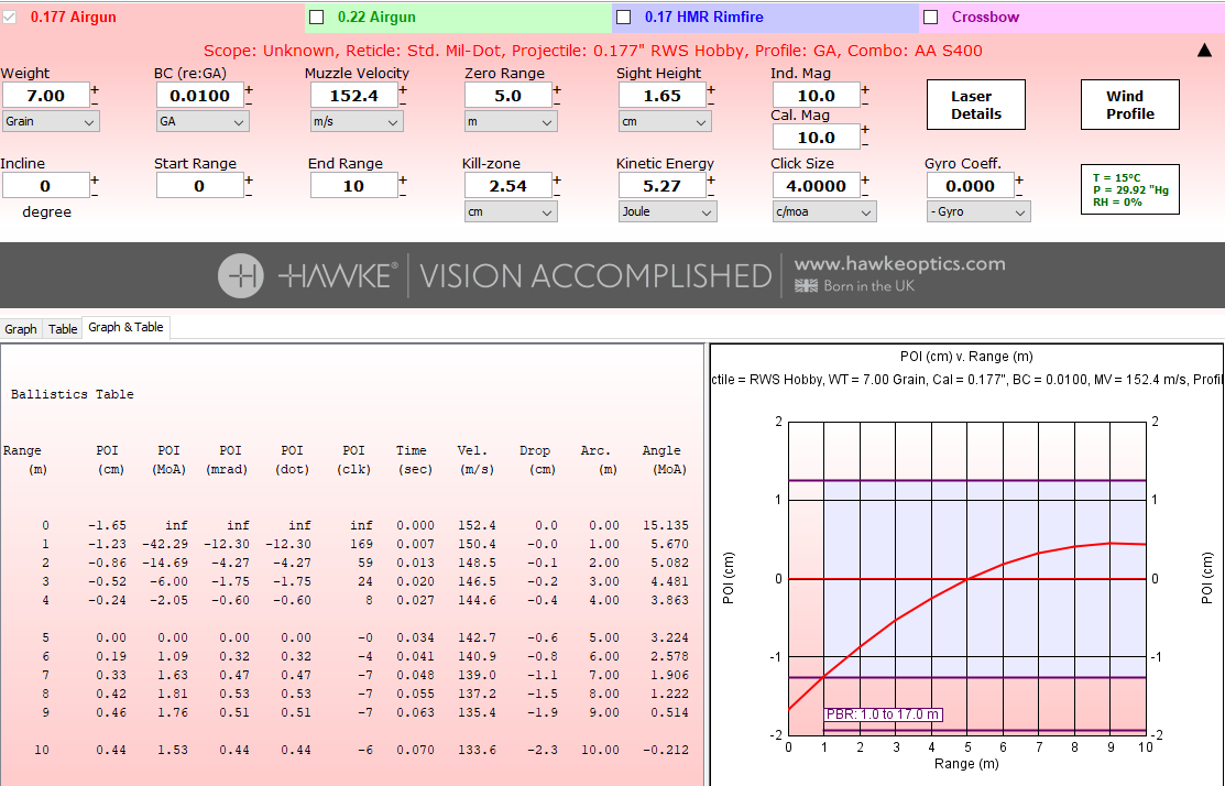

Wasatch,
Please re-run your software with the following adjustments:
Sight height = 16.5mm (0.650")
Incline = 0.511degrees
Start range = +0.7 meters (muzzle is extended past 10meter line)
Adding-in the Sub-6 hold dimension, I solved for angle of Barrel vs. Line-of-Sight, and got +0.511-degrees, with a Sub-6 hold using the 6-Ring as base.
My pen & paper method yielded: Pellet strikes 10-meter target +11.89mm high.

Unfortunately in ChairGun the incline minimum increment is 1 deg (and is for shooting at elevated targets as in field target).
Start range min increment is also 1 yd.
My thinking is:
The barrel axis has to have a positive incline so that the ballistic trajectory will intersect with the bull.
The sight line is fixed and doesn't change at various ranges assuming same hold (sub6), no change in blur at various distances, using correctly scaled targets and the reduced range target is at the correct height.
So to re-zero at various distances rear sight clicks are altering the barrel incline to raise or lower the POI while POA is constant.
For a 10m AP, whether POI needs to be raised or lowered when re-zeroing from 5m to 10m depends largely on muzzle velocity.
Holding the other characteristics constant, at ~131m/s there's a double zero at 5m & 10m.
Shoot faster (152.4m/s or 500fps for example) the 10m POI will be ~4mm high when zeroed at 5m.
Shoot slower (110m/s for example) the 10m POI will be ~7mm low when zeroed at 5m . Side note: effect of increasing blur at further distances (or varying brightness) isn't negligible. Actual re-zeroing clicks for you will most likely also be affected by change of blur unless adjusting eyewear (diopter/iris) to keep constant blur.
