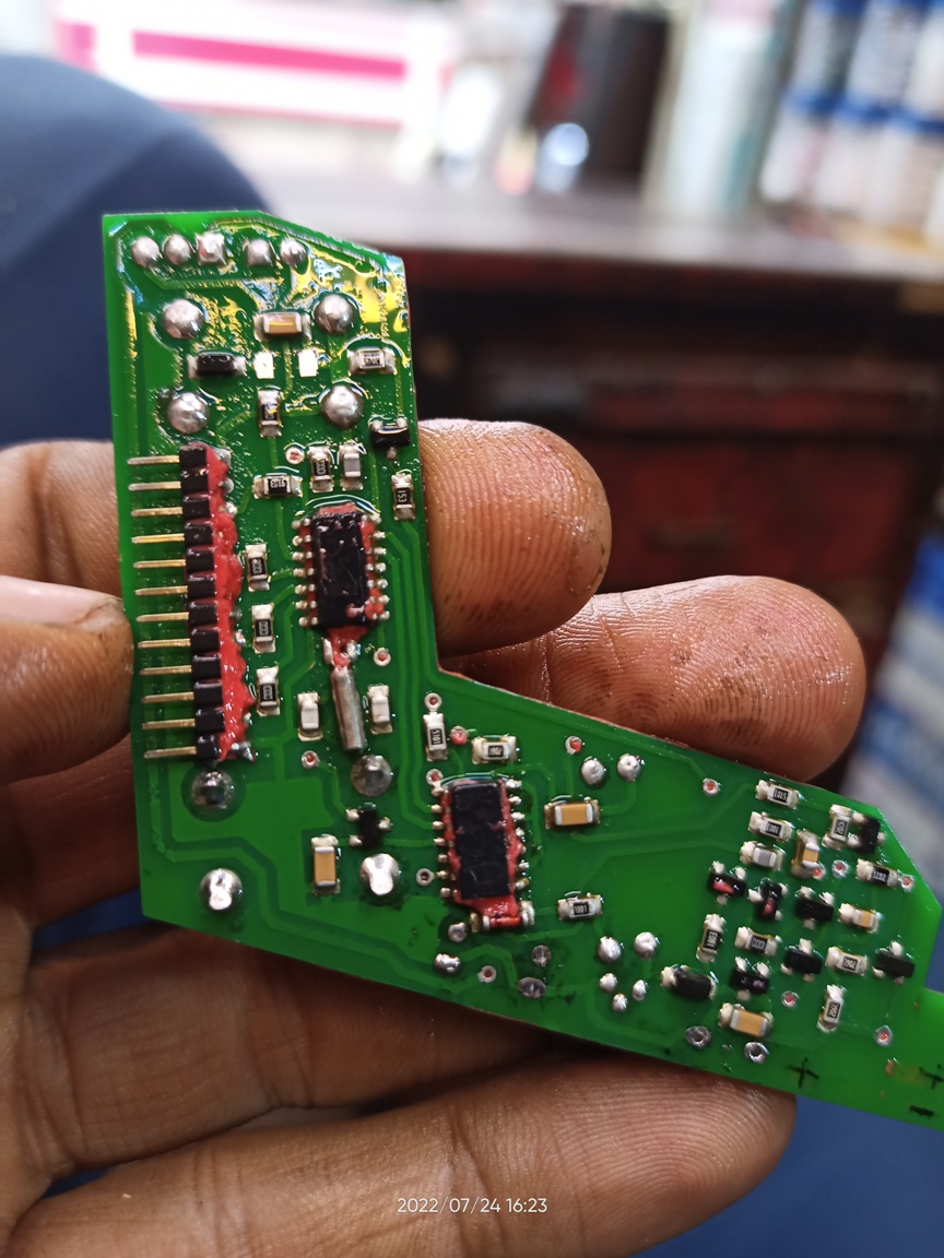

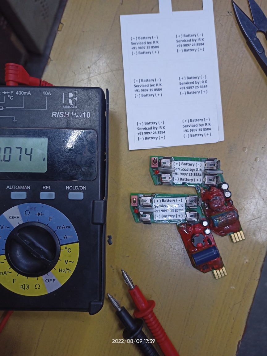

Before Repair
Before Repair
After repair
After repair
