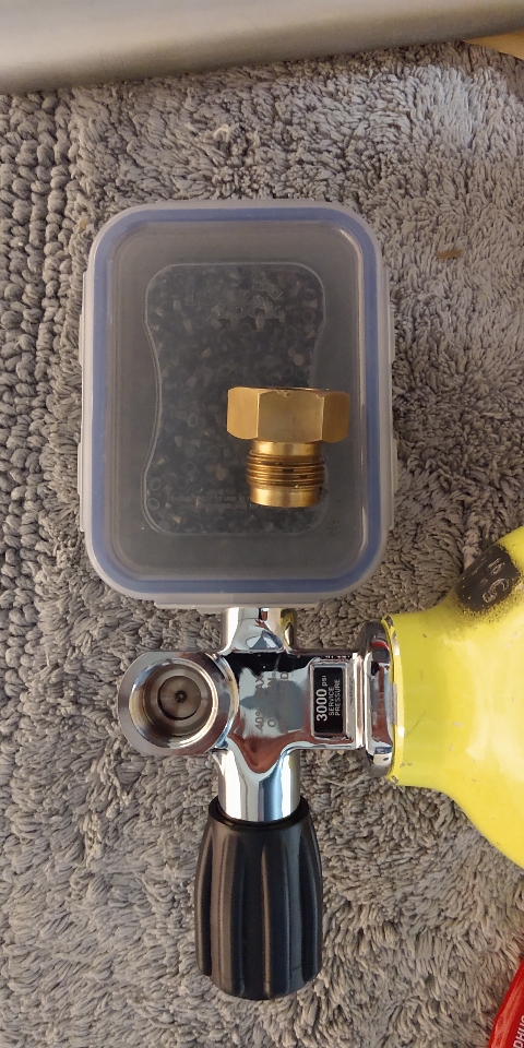

Currently I'm using a Hill hand pump but considering going to a scuba tank since there is a dive shop only 15 minutes away. For those using tanks can you tell or show me via photos or links of what fitting / valve / adapter I would need. This would only be used for pistol cylinders so I don't think I need a hose, just not sure what valve or fitting I would need to mount on the tank that would accept my cylinders as the Hill hand pump does.
Posts: 3572
Re: How are you filling your cylinders?
The typical setup for 200 bar cylinders starts with a SCUBA tank with a "K"" valve, and then you buy a K valve to 200 bar DIN adapter. You can get a straight DIN valve, but they are usually 300 bar. You need a DIN plug adapter to fill 200 bar cylinders, and SCUBA shops will automatically refill the tank to 300 bar unless you specifically ask (and watch them). That can be risky, and eliminates some nice options (like a good gauge and a bleed valve).
The nicest setup (which may be overkill for you) is a fill adapter with a good pressure gauge (the ones on the cylinders are notoriously variable), and a push button bleed adapter from Best Fittings in England:
https://www.bestfittings.co.uk/shop/air ... ton-bleed/
You want the one with no hose. Depending on the brand of cylinder, you can either fill it, close the tank valve and then hit the push-button bleed valve, or you may have to unscrew the cylinder a turn or so and then bleed it. Removing the cylinder the rest of the way with no pressure on the threads saves a lot of wear & tear, especially on aluminum threads.
Next, you need a 200 bar DIN adapter:
https://www.bestfittings.co.uk/shop/fil ... -bsp-male/
If you ask, they will assemble them for you. I ordered the 2 pieces separately and ended up without the high pressure washer that goes in between. The team I coach now has three of these. The gauge is especially important if your cylinders have no gauge (like Hammerli AP20's & 480K's)
