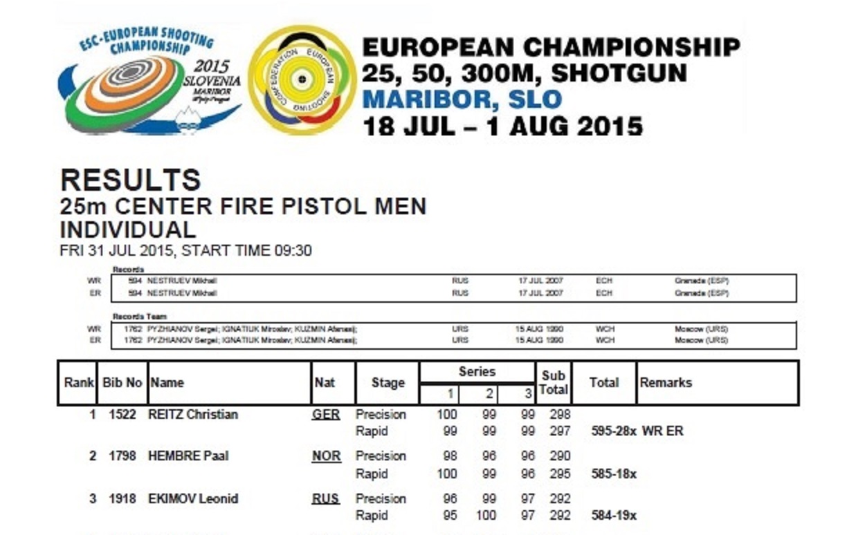

Here is the current World Record of 595-28x, not sure what firearm he used.
Someone on TargetTalk may have been there...
