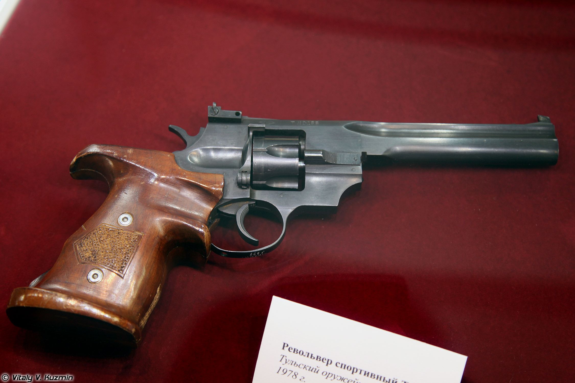

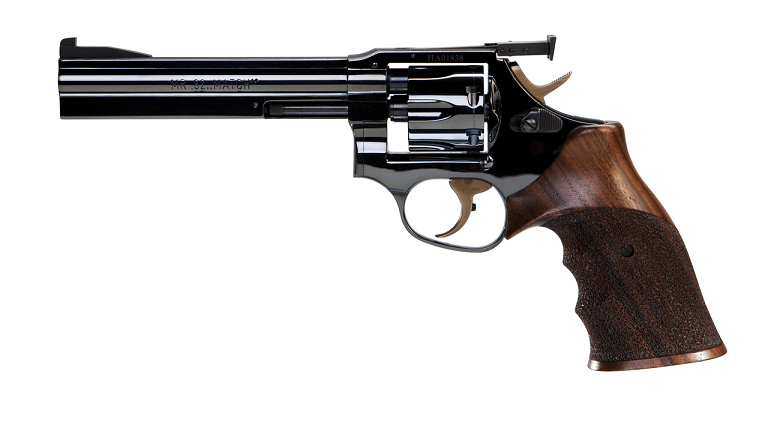

I remenber that in Rome (Italy) until 1980 I've seen good CF shooters able to score well over 580 with S&W mod 14 SA. BTW there are two different questions: 1) revolver vs semiautomatic; 2) 32 wc vs 38 wc. As far as I remember the present record holder is Nestruev, he uses a TOZ 49 in 32 wc, his score was 594/600 if I remember well.
Toz mod 49 32 wc
Toz mod 49 32 wc
Manurhin 32 wc
Manurhin 32 wc
CZ ZKR 32 wc
CZ ZKR 32 wc
