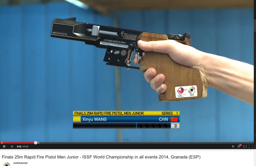

If you just relax your thumb, the tip can droop a little bit. That's what i see in a lot of the air pistol images. The position used by the rapid fire shooters is much more extreme, and has to require some muscle action to achieve. The new Morini grip that started this thread isn't that extreme:
The entire thumb is tilted downward in a fairly straight line so it's about in line with the trigger finger.
Here are images of the more extreme thumb-tip down position used by some of the rapid fire shooters:
and
http://www.eley.co.uk/media/wysiwyg/25m ... idFire.JPG
But it's hardly universal:
To each his own. One advantage of shaping the grip the way the Morini 200 has done is that you now have a broader range of thumb positions available without having to attack the grip with a file. If you relax your thumb, it's unlikely to run into the grip.
If it was all that important, I would have expected the higher level shooters to have taken a file to their grips long ago. There is no sign of that in any of the rapid fire photos I found.
