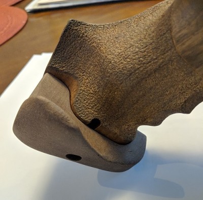

Another +1 for Andrew's service. He whipped up an upswept palmrest for my Benelli MP90S stock grips, working from photos and measurements. It needed one revision but the end result just needed some sanding/finishing to achieve exactly what I wanted. Photo attached, thanks Andrew!

I should perhaps add that we chose his "wood composite" option for my palm shelf, in "walnut" (his darkest) color. It is quite strong and after sanding with 120 grit has an ideal texture for my goal. I was able to finish it lightly with stain and a danish oil. The color is a bit different from the grip, but came out rather attractively contrasting.
Here's a second angle that shows the material's wood-like appearance a little better:
