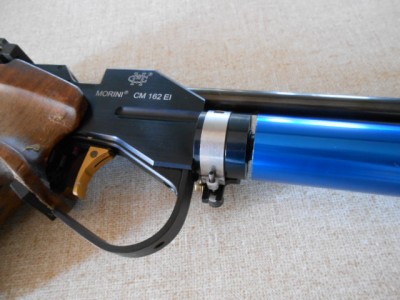

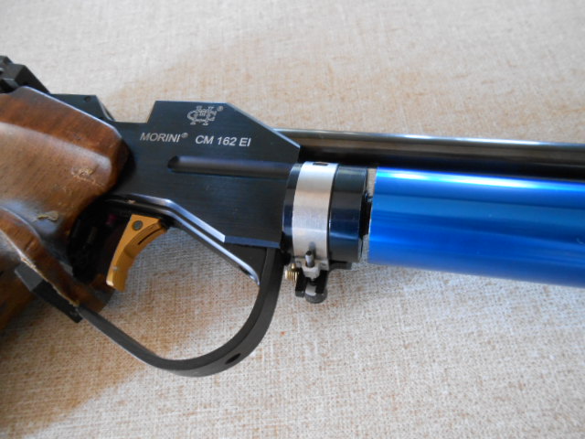

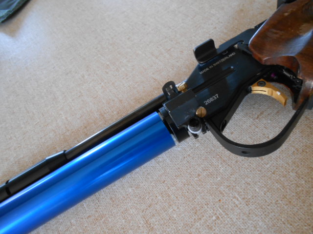

I had a friend who was using a mechanical 162, and was having no trouble with the MX-02. Examining both pistols revealed that the mechanical pistol had a significantly stronger "click" which set off the scatt, with the MX mounted on the end of the cylinder behind the gauge, as is the usual case.
The mounting block and band are positioned against the pistol body, with the band mounted on the round section immediately behind the cylinder mounting block and in front of the pistol body.
By moving the scatt mounting to the body of the electronic version, the scatt functions perfectly. I now have the mounting permanently attached to the CM162EI, which makes set-up easier. The piezo setting is set at 1.6 - 2.0.
