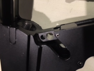

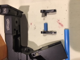

I've fixed mine, crudely but very effectively.
Firstly I drilled/reamed the 4.5mm hole in the frame to 5mm and pushed in a bush made from brass. The brass didn't work even with fine clearances so i made one from aluminium. The aluminium was better but still sticky. Then i got an environmentally unfriendly plastic drinking straw, cut the end off and split it lengthwise and curled that into the frame. Magazine ejection button works great now. The straw bush is the length of the pin on the latch so it slides in the frame. Do not use your regular battery drill to drill/ream the hole in the frame - use a proper drill press with the gun frame held in a vice.
Re: Question for Walther SSP Owners
Would like to see a pic or 2 if possible. Thanks for the fix.jbshooter wrote:I've fixed mine, crudely but very effectively.
Joel
photos attached
- IMG_0596 (1).JPG (21.4 KiB) Viewed 3906 times
