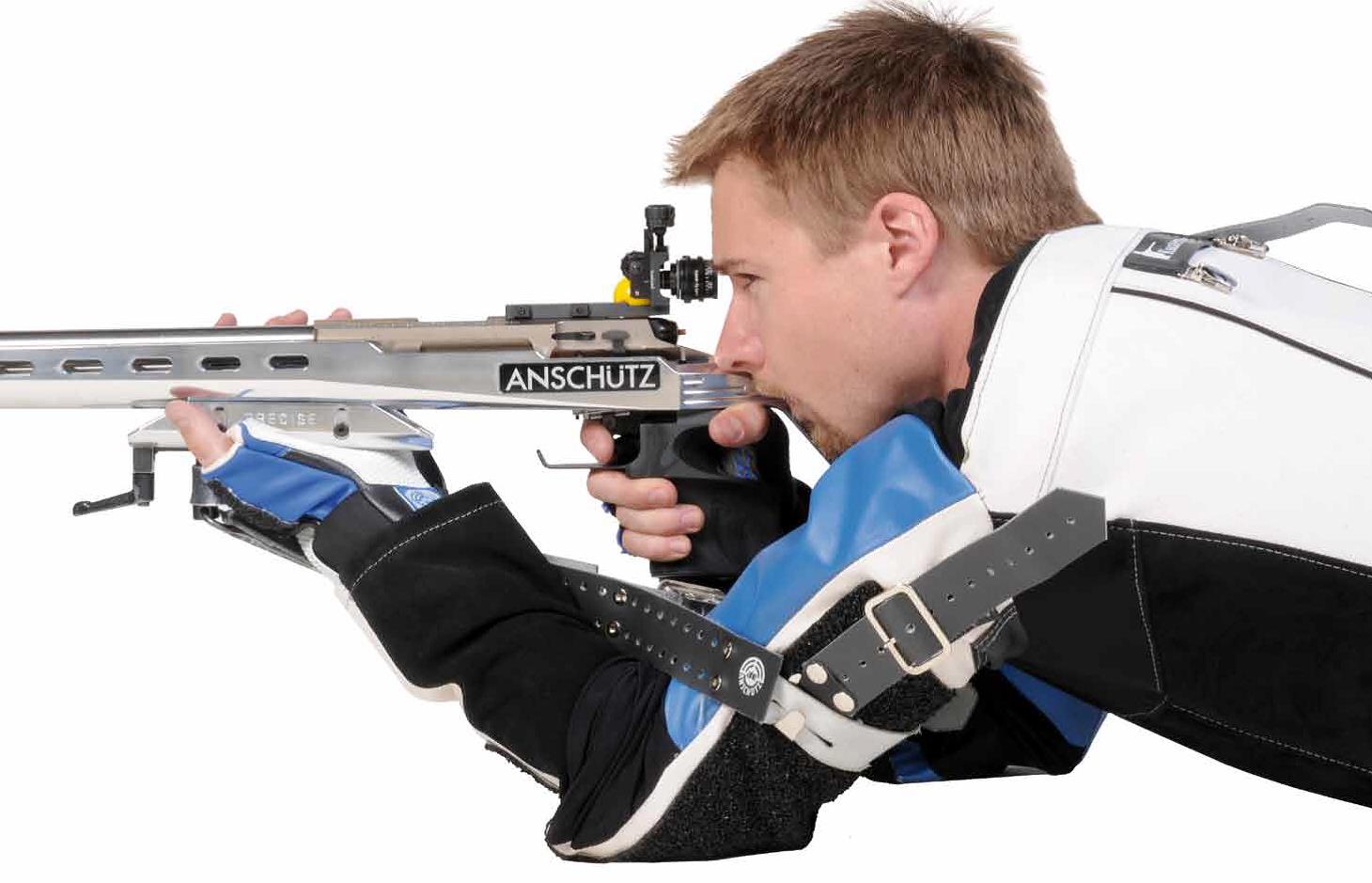

Alternatively Matt Emmons uses a fore end riser to get the same head position (although I know this is an old photo) raising the whole rifle as opposed to just the sights. I also like the idea of raising my right hand up too.
Re: Riser Blocks and accuracy
His eye is impressively well aligned, I must say, and he looks comfortable. And, yes, now that I think of it, a slightly more vertical right hand would seem to have the advantage of increased stability and control for the trigger finger.Bryan996 wrote:Alternatively Matt Emmons uses a fore end riser to get the same head position (although I know this is an old photo) raising the whole rifle as opposed to just the sights. I also like the idea of raising my right hand up too.
The fore end riser does, however, rather negate the advantages of a shallow fore end, but perhaps the modern fashion for the latter is overdone? If so, what am I doing with an expensive Gemini stock? It's all getting a bit confusing for the poor old, very average club shooter.

I wouldn't go jacking up the fore-end immediately. Matt Emmons is almost the only male shooter at that level who has raised the rifle*. Since he switched to a Bleiker rifle a few years ago he no longer used the raiser. His position as a whole isn't completely textbook; he lies very straight and has pretty high shoulders. It works very well for him, it's not a variation you often see.
The very shallow fore-end of the Gemini can reduce the leverage that can be applied, much like raising the buttplate does. However, the block that Emmons added brought his cast-alu 2313 to about the same depth as his old walnut 2013. The 2013 does not have a very deep stock, certainly much better than the old UIT standard rifles.
*It's more common among women to ensure clearance from the ground and from the sling.
