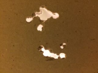

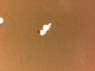

In my opinion it doesn't matter what pellet you use, what matters is to balance the gun to the pellet. the attached were shot at 20 yards with the gun in a clamp, 10 shot groups.
they are R10 4.50 pistol, pistol was a FWB P44. if I shot in competition with the gun not adjusted to the pellets, my score over 60 shots would be noticeably less.
Power screw set to low:
as screw turned up:
Optimum power for this pellet:
as screw turned up:

Re: Drive U nutz pellet test
I think there may be much to what you say.
I admit I have not pursued the "ultimate accuracy" by trying velocity variation to any degree.
I HAVE had many rave at me over the wonderfulness of their spendy pellets without ever having tested them.
On one pellet test, I reshot it with the velocity increased and got an across the board improvement in accuracy. On another occasion I received a new batch of pellets that tested VERY poorly. I cranked up the velocity and was rewarded with exceptional groups. I'm using the last tin of those and only in the test gun.
My testing these days consists of testing a new batch (10,000) to see if it's OK and go no further.
