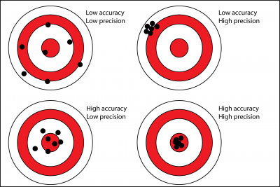

Hi everyone
Just an education question for my own understanding if you don't mind:
Is there any scientific/unbiased experiment you could point me to that demonstrates match grade pellets (any brand) to be statistically better (i.e. more precise) than the RWS Basic pellet?
I would really appreciate reading/checking that study, preferably from an independent source not 'linked' to the marketing department of the match grade pellet that is being tested.
Also, from my understanding, please correct me if I am wrong, the equipments (pistol/pellet combination) will only provide the precision part... Accuracy being more of a function of how good the shooter is. This Makes winning a match roughly a 50/50 ratio between accuracy and precision. What do you think?
Fadi
