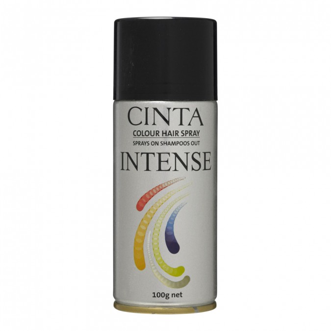

Posts: 1718
Re: Sight blackener
A good ,cheap and hardy sight black.
Cinta Intense Colour Hair Spray Black
Mtl_Biker
Posts: 204
Joined: Tue Apr 26, 2016 8:06 am
Location: Montreal, Canada
Re: Sight blackener
Post by Mtl_Biker »
David M wrote:A good ,cheap and hardy sight black.
I'm guessing that is a serious suggestion... Just did a Google search and could only find it in Australia. Doesn't seem to exist here in Canada.
