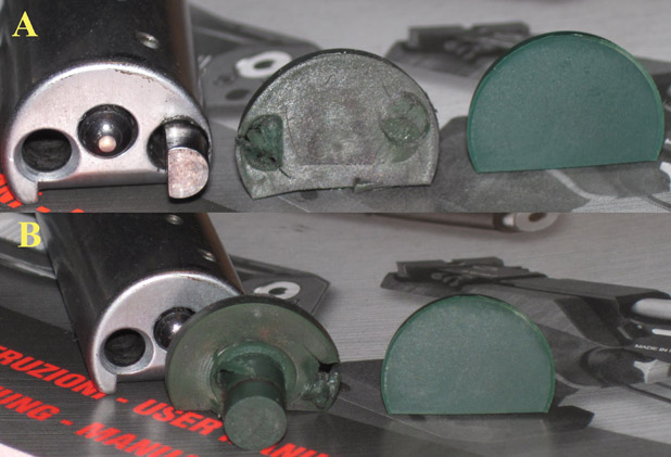

I happened to use a bright light to check the condition of the rear shock absorber in my Pardini SPBE. I observed a "small" crack and thought it prudent to order and replace. The manual does not indicate how often the absorbers should be changed or even how to do it, but the "small" crack indicated a change was needed. Changing the unit is straight forward.
Just push out the old shock absorber out from the rear of the frame (grip must be removed). I used a 1/2" dowel to install the new one by adhering it with some grease to hold it on the end a dowel; after a few tries I got it lined up correctly.
In the attached image you can see the "small crack" I saw (Fig. A) and the following image (Fig. B) shows actual damaged done to the absorber. Needless to say, boy am I ever glad I checked. I would hate to hear what the bolt hitting metal sounds like.
I bought the pistol in late April 2014 and estimate that I've put ~8400 22 lr. rounds through it (all standard velocity), plus another 2300+ 32 ACPs (~850 or less fps). Since both barrels use the same frame, the shock absorber does double duty. I consider this normal (maybe even light) use for a BE shooter. Considering the popularity of this pistol among BE shooters and the recency of its availability in the U.S., I suggest every owner shine a strong light down the frame to examine the condition of this important part.
Most damage to the absorber is done by the rear of the dampening rod (part 770, the semicircular extension on right of real bolt), which is only on the 22 lr barrel. The lower figure (B) shows the back of the worn absorber and actual the extent of the damage. Scary. Happy Halloween, dipnet

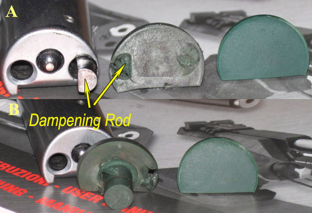

Because I shoot I shoot both 22 lr and 32 ACP with my SPBE, Alex Chichkov recently confirmed that I should remove the dampening rod (part 770), rod pin (769), and the dozen or so O-rings (771) that occur behind the dampening rod in the in 22 lr bolt. The dampening rod is not found on the 32 ACP bolt. The clear cause of damage to the rear recoil absorber was caused by the dampening rod slamming into the rubber absorber (see photo).
The dampening rod is easily removed from the 22 lr bolt by punching out the retaining pin (the one closest to the rod) with appropriate punch on a bench block. After you remove the rod, pull out the first 2 or 3 O-rings using the punch and most of the remaining rings can be gently tapped out, likely except for the last stubborn one. Alex cautioned that the rear recoil absorber should be checked annually for possible damage and replaced as needed (depending on how much you shoot). I reconsidered estimated ammo shot since buying the pistol in spring 2014 and suspect 22 lr is ~4000 rounds or less plus ca 2000 rounds of 32 ACP. Now it is easier to lock the slide back in 22 lr.
In the attached image, you can easily see where the rear of the recoil dampening rod had impacted the rear recoil absorber. Best, dipent
