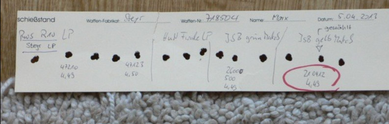

Here's a German test, RWS R10 light pellets didn't perform well in none of the six guns they tested. R10 heavy did better in all of the guns. Same with JSB pellets, the heavy pellets performed better than light pellets in all of the six guns.
To give you an idea how bad and how good pellets get look at this. The worst you can get is about twice the size of a pellet, which is acceptable for training. So, don't be scared if it's cheap. Don't bother with expensive if you can't hold the 10 ring.

Oh, bullshit! In his "exhaustive test research" he never looked at my multiple test reports on TT. They are the reason so many have switched to RWS Basic Diabolo on TT.
Basically, there is NO difference in accuracy between heavy and light, head size, or brand. ONLY the lot number of various pellets, determined by actual test with YOUR gun, is of any importance.
Don't believe me? Ask the guy who makes pellets.....Pilkington.
BTW Using three pistols and two lots of JSB light pellets, they outperformed every other pellet every time, but I'd still want to test again (but I don't waste my time with that stuff anymore, I just use the RWS Basic for everything.)

Absolutely! I use a heavy vise, usually clamped on the trigger guard, and 25 or 30 shot groups. I measure the groups with a Mitutoyo dial caliper with strong closeup glasses using top of the line targets so that a clean hole is cut.
I can safely recommend RWS Basic Diabolo pellets for you since they performed so well in my tests and are the cheapest decent pellet I know of.
