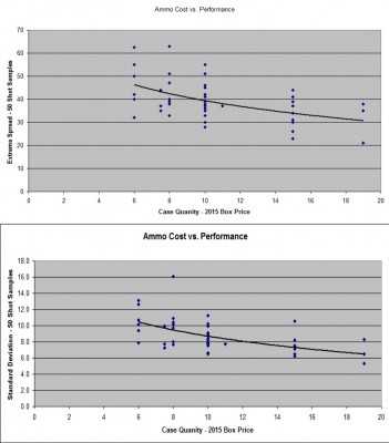

Chronographed three lots of Tenex today - 50 rounds at 100 yards in prone position with my wrist supported. One of the three lots showed good performance numbers and the other two were average. But the good one's published velocity was way low. The other two were on their published numbers. The 54.30, however, didn't want anything to do with the Tenex. Perhaps the 16 1/2 twist was the cause. Some very good RWS R50 grouped OK, but a run of the mill lot of CenterX shot the tightest groups (used these two as controls and they were shot last when the wind had increased).
Mark
