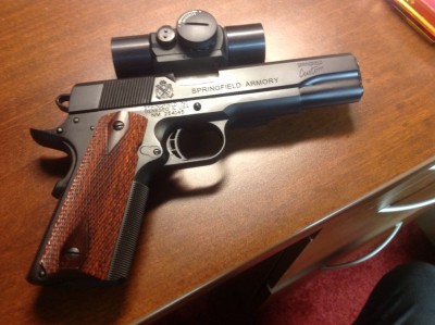

Does anyone have any insight into the pros / cons on the mounting height (distance away from the gun's slide) of a red dot sight?
I would like to keep it further away from the rail (approximately 1") to reduce the impact of ejected casings (potential jams and constant impact to the red dot housing) but know that mounting further away from the rail increases the amount of change in the actual POI as the distance from the sighted in POI increases.
Thanks!

1319 wrote:Does anyone have any insight into the pros / cons on the mounting height (distance away from the gun's slide) of a red dot sight?
Thanks!
Is this on a 1911, slide mount or frame mount? The dot on my 1911 is less than 1/4" above the rail. No issues with brass hitting the dot, no jams, etc.. gun runs perfect.
You really want it as close to the rail as possible especially if it's a slide mount. Having a dot 1" above a the slide on a slide mount may make it more difficult to recover during sustained fire.
If your brass is ejecting too high you may need work on your ejector/extractor.
