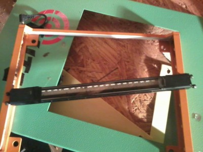

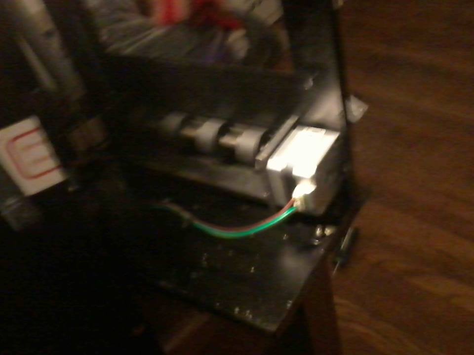

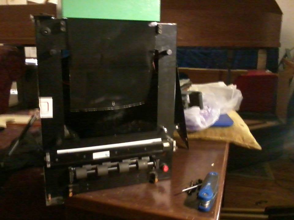

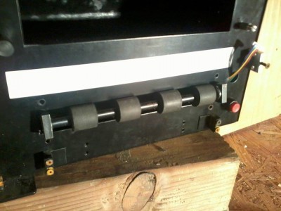

I take apart this box under real time instruction and permission, staying up in the middle of the night due to timezone difference from India.
The Box Front and Mask taken off IR reader. The roller system at the front. This is the archilles heel of the system.
This is the roller frame - rollers - motor unit. It is poorly made with torn and strip screws. It is impossible to repair any part due to this problem so any repair means the entire unit needs to be replaced. This unit lasted less than two rolls of target paper!!

This really sucks. I had some hopes for this unit as a viable alternative to some of the really expensive units. Is there any chance that you can alter/repair the unit yourself? If Elite Scorer isn't answering your communication, then it appears that they obviously have no intentions of honoring their warranty.
The roller unit looks to be something out of any modern day inkjet printer? Stripped screws can be drilled out and replaced easily enough...
