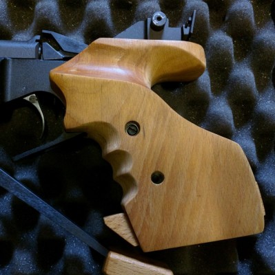

A lot of the Baikal reviews I read said that the grip is on the large side, and that most shooters will need to adjust it to fit them. After shooting it for a while I found this odd, as I have fairly small hands and it fitted me quite well. It was only after shooting it for a while that I realised I was holding the grip wrong, and that while it felt comfortable I was holding the pistol at an angle so when I pulled the trigger it was pulling the gun slightly to the side rather than straight back. Once I gripped the pistol ‘properly’ I did indeed find it was uncomfortably large and it was time to get some sanding done. I looked at third-party grips like Woods and Waters and Rink, but until I can shoot better I can’t justify the cost.
I treated myself to a Dremel for my birthday and started working on the grip. I read a few guides online and followed the general process of holding the gun, making some pencil marks on the grip for where my hand sat, and then sanding with the rotary sanding drum. Once I had the majority of the wood removed and the grip felt comfortable, I changed to 240->400->600 grit wet and dry paper to make final adjustments and sand the wood smooth.
Here is the grip after the first round of shaping:
After first round of grip shaping.
At this point the grip largely felt right and when I held the gun out the bore axis lined up with my hand and arm, but there were still pockets of empty space in some areas between my hand and the grip that needed filling. I’ve no idea if you can buy Morini grip paste over here for a sensible price, but I just used regular wood filler. I tried matching the wood colour first, but it didn't look great so I used grey for contrast instead - this is never going to be a 'pretty' gun anyway (I understand it has the nickname ‘industrial stapler’).
My technique was to work out where the 'pockets' were, apply wood filler to these areas, then put some cling film (I think you call it saran wrap in the US?) over the top and squeeze the grip in my hand. This left a fairly close imprint of my hand in the required areas. Once the filler had started to dry I peeled off the cling film to let the air cure the filler properly, then once completely dry it was sanded. A couple of extra bits of filler were added afterwards to raise areas that needed it, then these were again sanded until I was happy with the grip. A coat of Birchwood Casey Stock Oil was applied to the grip to protect it and match the original finish.
Here is the 'finished' grip in its current state:
After second round of grip shaping and wood filler.
I’m now at the point where the grip fits like a glove and feels a lot more stable. I also moved the trigger back a little and it now feels like I’m pulling straight back instead of to the side. I think the trigger might benefit from being a little lighter, but for now it’s not the biggest problem (my lack of skill is) so I’m leaving it alone until I make a trigger weighing system to make sure it’s not too close to <500g.

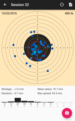

My first question to you all is what is a ‘good’ score for an amateur? I started using the TargetScan phone app (https://play.google.com/store/apps/deta ... n&hl=en_GB for Android, https://itunes.apple.com/us/app/targets ... 45769?mt=8 for iOS) to track my scores and have found it is the perfect companion tool for tracking my ability.
When I first started keeping track of scores, I was shooting somewhere around 75-80ex100. I would typically shoot 30 shots in a practice session and score somewhere around 230-245, with the majority of shots being a 7 or an 8. If I scored 9s, 10s or 10xs, then it felt like luck as much as anything else.
Since finishing the grip shaping (only last week), my scores are more consistently over 80ex100 with mainly 9s, and I shot my personal best of 89-2x. Are these scores reasonable for someone who has been shooting for around four months now? I know I still have a massive amount to improve on and I'm enjoying myself so the score doesn't matter too much right now, but am I in the right ballpark? I would personally consider a 500ex600 to be a good score right now and I am working towards consistently achieving this. Below is a screenshot of a recent 60-shot session. As you can see, there are a lot of 'fliers' when the physical/mental fatigue kicks in. If you ignore these (if only scoring was that easy!) then to me it looks like a decent group for an amateur?

Your scores are not at all poor for as new to shooting as you are. In fact, if you took that target and just figure out how to avoid the 9 shots in the white (6s or lower), and could instead shoot 9s (you shot almost twice as many 9s as anything else), your score would be a 520.
Work on learning to "feel" what a good shot is like. Then any time you start to deviate from that feeling, put the gun down and reset for another attempt. Letting your ego take over because "I can still shoot a good shot" is increasing the chance for a bad shot. That includes holding for too long. You may get lucky and shoot a good score after holding for 20 seconds, but how long do you hold for most of the good shots? Make that your personal target, and put the gun down if the shot doesn't break within a second or two beyond that.
10 Meters is measured form the face of the target to a plane that your feet can not touch or cross. Most ranges have a line on the floor marking that distance. Your arm and gun can extend beyond that toward the target.
The grip can only touch your hand. If the shelf touches anywhere beyond where the bones in the hand end, even just the flesh, it is likely illegal. You should trim the shelf off so you can tilt your hand down beyond normal shooting position and not touch the arm/wrist.

You did a nice job with the grip, but I have to warn you that after several years I am still giving minor tweaks to my two AP grips. Some of other shooters laugh at me, but they don't outshoot me.
BTW I have completely eliminated any "finger grooves."

Thanks Rover, I had a feeling that might be the case which was why I put 'finished' in quote marks. ;) They certainly feel a million times better than they did out of the box but I'm sure there's still work to be done.
I quite fancy making a set of grips from scratch from a wood blank. I don't think the outside would prove too much of a problem, but getting the inside routed properly to match the metal of the pistol frame and ensuring the screws lined up perfectly might be a little harder. Maybe a project for the winter months...

I've found that the most critical part of the shaping is in how the grip tapers from front to back. By removing material from one side or the other you alter how the gun points. Refining this helped me insure the sights lined up properly.

I first tried plastic wood to fill my grip, but it STUNK. Then I had Seaton Thomas adjust my grip, and he used a kneadable expoy and that worked much better than the plastic wood, no SMELL. And the epoxy was easily shaped with a rotary sander/Dremel.
Rather than grabbing the grip to fit, Seaton and I followed Don Nygord's method of adjusting the grip so that it makes the hand do what I want it to do. Since you have Don's notes, you should find the grip fitting article in there.

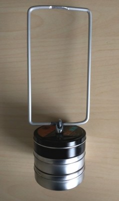

I also decided to weigh my trigger pull so I built a thing:
Trigger weight tester
I was surprised to find the trigger was set to 450g; I expected it to be higher than that. The tins are filled with coins, nails and washers, so added them as needed and gave the trigger weight screw just over one full turn (re-testing with different weights and screw rotation in between) which has set the pull to somewhere between 540g-550g. I figure there's no point in tuning it any more than this until I have access to a more reliable testing method. I haven't shot the pistol properly yet but hopefully this won't have detrimental impact on scores.

This is the most reliable testing method, you can fill them with used pellets too like I did. You can also experiment with first stage weight by removing one can. Not even sure if izzy has a 2 stage trigger.
the are people who use the joint for the trigger, they're usually people with long fingers. Do whatever feels best, but experiment either way, write down if you liked it or not, I write everything down, because I'm surprised how much I forget if I don't.

Cheers, my biggest concern about accuracy was the scales I was using to weigh the tester, but they're digital and my partner uses them for baking and her cakes turn out well, so they're probably about right.

A digital kitchen scale should be accurate enough (1 to 5 grams error).
Make your test weight 510-520g, and adjust your trigger so it just barely lifts it without firing.
That would take care of any error the scale may have. And you won't notice the extra 10 - 20 grams when you fire it.
Make sure you put the test weight on the middle of the trigger AND keep the barrel 90 degrees to the table top.
