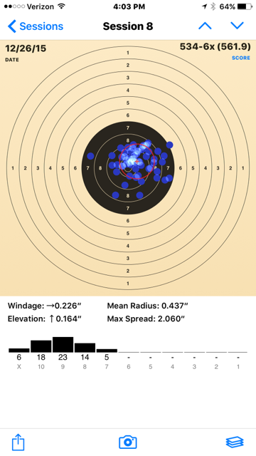

The app TargetScan does the same thing as a backer target but much more neatly and accurately - I adjust sites based on it and find it works very well. It also keeps historical data which is helpful.

Until they can properly call the sights, and call the direction of movement during squeeze no turning of the screw.
Once you can call the sights accurately. 2~3 clicks per scoring ring. Be not afraid of the screwdriver. Lighting conditions on the target, lighting above the shooting bench and sooting on the sights all affect my shot placement. I have learned to re-blacken the sights before going after a screwdriver.
So if the whole team is doing it because the kewl kids do, Make them explain why.
At a CMP match where electronic targets are used. I always adjust sights to that particular machine. Often I've found where the machine thinks the middle of the target is located is not always where I think the middle is. I shoot a sub-6 hold so that tends to vary based on lighting down range.
