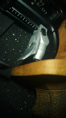

I have made a new trigger out of Aluminium as the supplied trigger was too small for my finger; I made it wide, flat and straight with a curve at the bottom, and it is fine to use. Development is still in its infancy though, but target test and dry fire test seem very positive. I can have it in line with the barrel and not have to cant it to fit my finger pad.

Looking at those pictures
You must have very short fingers
My trigger is set a lot more forward
Do you have small hands?
What size grip do you have?
Re: Feinwerkbau P44 review
Lol yes I have big hands but small fingers. It can be a problem as a medium grip will be right for my fingers but to small for my hand. I use a large grip.jerber wrote:Looking at those pictures
