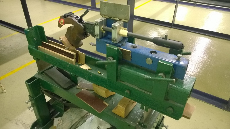

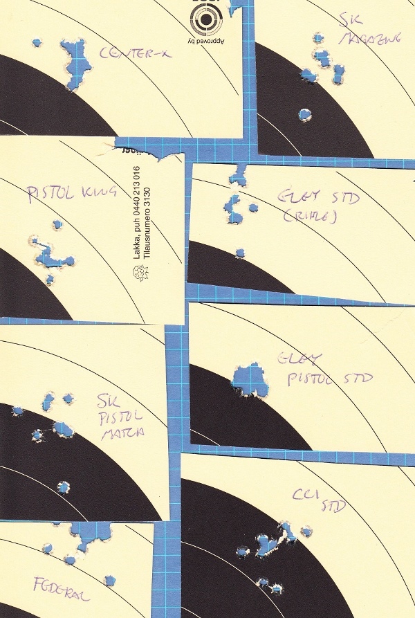

I bought a second hand Morini CM84e 50m pistol a year ago.
The pistol was very cheap so I thought maybe there is something wrong with it..
My club has a testing jig for 50m rifles that can be used for some pistols too, so shot 10 shot groups using different cartridges I had at the time. All were low to middle price range (3,5-11€ / box of 50).
Conclusion; Barrel seems to be ok. All tested cartridges give 100p score, Some give 100p/10X groups.
So no matter what cartridges I use, pistol is way more accurate than I´ll ever be.
Those Eley pistol standard rounds are old. I have maybe 1500 of them left.
When they are gone, I´ll start using cci std, Topshot comp or SK Magazine. Not because of their accuracy but because they are inexpensive and work reliably in my standard pistol. That SK magazine is good training round for my 50m rifle.

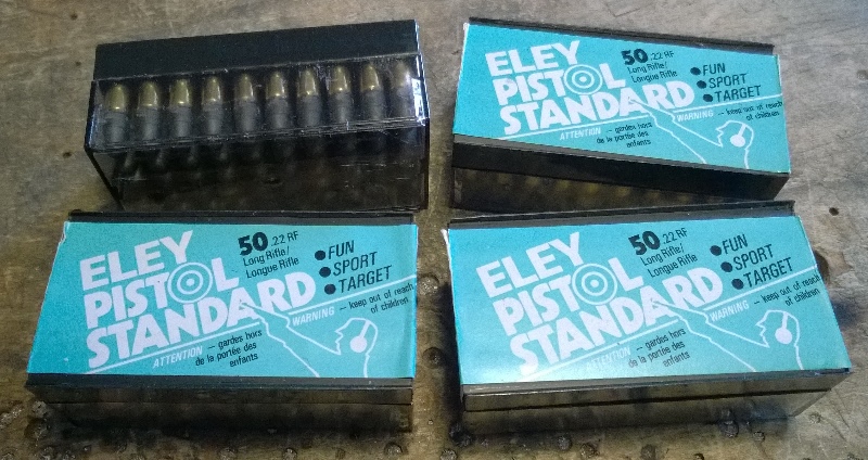

Could you be more specific regarding Eley std. Looking on the Eley website shows no product that matches your description.
Re: Free pistol match ammo
The old Eley Pistol Standard (about 2010) is now called Eley Sport.
Its a general purpose pistol cartridge - Muzzle vel. 314m/sec (1030 fps)

At least in the USA, "Eley Sport" came in a purple cardboard box, and was made in Mexico (probably by Aguila). That disappeared off the market a couple years ago. "Eley Sport" now seems to be sold in a plastic box similar to the rest of the Eley line, with a green label. In the USA, it is sold as "Eley Target", with a bright yellow label.
The purple stuff was quite good, and relatively inexpensive. Early on, it was less than $20 a "brick" (500). I picked up a couple cases a few years ago for a bargain price because nobody seemed to know what it was good for in the US, and my local gunshop's distributor decided to stop selling it. Eley Target is considerably more expensive (but all .22 ammo is these days), selling for between $65 and $75 a "brick" (500).

Like I wrote, those Eley pistol standard rounds are old.
Don´t know how the "FL90" lot number relates to mfg year..
Box picture attached.

Thanks....interestingly the best group by JiriK came from what is now Eley Sport....the cheapest in Eley's lineup.
