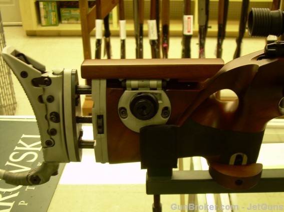

Re: Anschütz 1813 L buttplate question
There's codes on the barrel to tell what year it is, if it's the original barreled action to the stock.
0=A; 1=B; 2=C; 3=D, 4=E; 5=F; 6=G; 7=H; 8=I/J; 9=K
so ID would be 83. The 82 super match had the old crescent type butt plate. Don't know when the 4760 started.
Also note if the aluminum spacer of the 4760 with the hash marks on it isn't the same size as the steel butt part that goes in and out, it's not the original butt plate that came with the stock. The earlier 1813 stocks are a bit higher.
Here's a pic of an early 1913 stock with the 4760 butt and hinge type cheek
- gb1913 3.jpg (52.99 KiB) Viewed 4780 times
